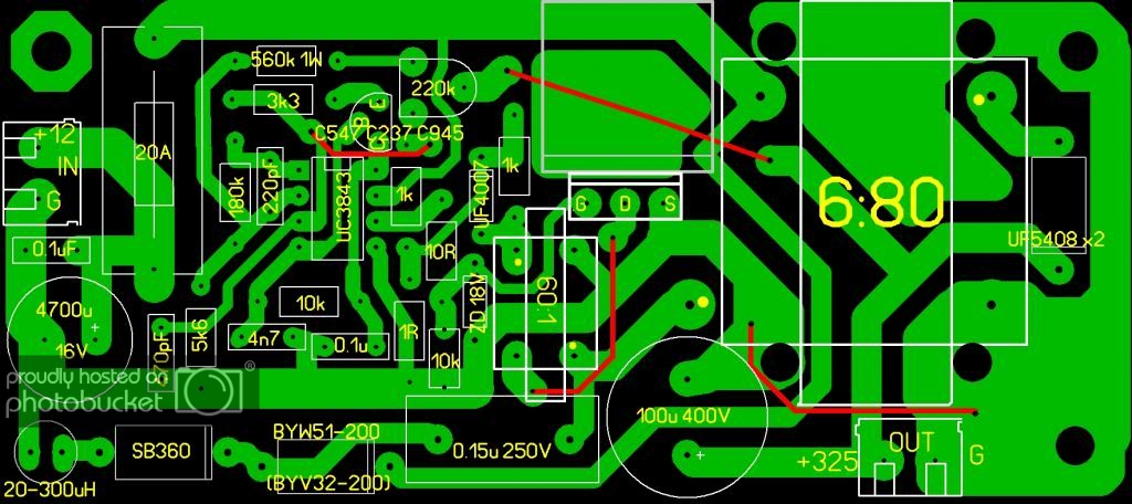

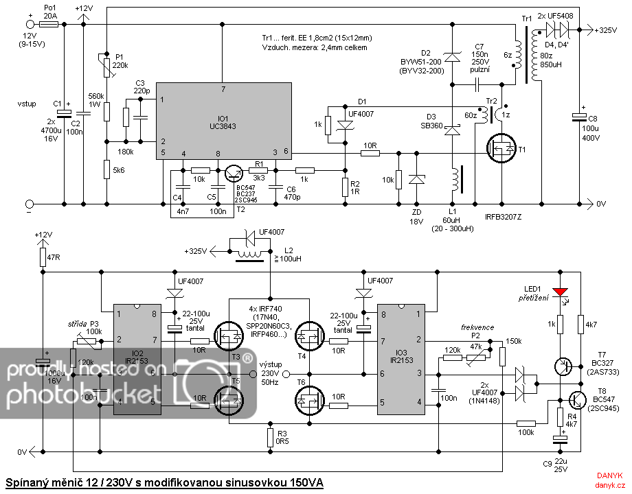

I finally decided to try to make an inverter, so, after searching for a manageable circuit, I settled on this one http://danyk.cz/menic230_6_en.html.
There was no PCB, so I made my own for a DC booster part. Most likely it is a bad design, but I'm far from being an expert in electronics.
Can you, please, check with a fresh look it against the schematic for mistakes? I'm asking because, while waiting for an UC3843 to arrive, I took a used UC3842 instead to test the circuit, but it didn't work, and the IC got quite warm, but not hot. Luckily there was no smoke :). Supply voltage was 22-23V (something to do with a start-up voltage of the UC3842 at 16V), not 12V.
The voltages at the IC's pins:
1. 1.34
2. 0.68
3. 0.0018
4. 0.568
5. 0
6. 0.0025
7. 23
8. 1.28
One thing you might want to watch out for is the clearance between your 325VDC rail and lower voltages. Same also between your inverted output and lower voltages.
If the traces need to run close (say to the leads of a capacitor or an optocoupler) then you may consider placing a slot in the board.
Yes, that's the problem of bad (mine :() PCB designing. But so far it doesn't look like there's ever going to be a 325V output from this inverter...

Your gate drive voltage (Pin6) is lower than I would expect for any duty cycle >25%. Do you have a scope to see what the peak voltage is?

Is your board layout as viewed from the component side or underneath? It appears to be from the component side.
One obvious problem is that your power rail measures 23V when your schematic says it is 9 to 15V, however I take the point that the chip you used has an undervoltage lockout requiring more than 16V to turn on.
However you need to take into account the fact that other parts of the circuit might be designed for a lower voltage.
One obvious thing is the zener diode protecting the gate of the main switching mosfet. This is a 16V device and the current through it is limited only by a 10R resistor. At a 23V input voltage it would be conducting heavily and would explain the heating of the chip.
However you measure the voltage at pin 6 as 0.0025V. Whether this is because it is at effectively ground level, or if it is because the duty cycle is low, I can't say.
What is the voltage on the output capacitor? Is it 300ish volts?
It is also possible that the zener diode is inserted back to front.
The PCB design fro the pin 6 through the 10R resistor, the zener and the 10k resistor and then on the the gate of the mosfet seems right.
I assume T2 and the associated circuitry connecting it back to the chip are for cycle by cycle current limiting, but I can't comment on what, if anything, might be going wrong here as I don't really know how this chip is typically used.
Beware of getting the phasing of the windings of T2 wrong. Although that's probably not a factor in you problems at present.

The board is viewed from component side.
The datasheet says, that the output voltage should be 5V Charact.GIF , so I'm not even sure, why that zener is needed at all there. If it was inserted incorrectly, still there should be al least 0.7 or so volts, I guess.
There is almost zero voltage at the 325V side- after connecting the power supply, the voltage slowly rises to about 0.6V and that's all :(.
About the transformer phasing, well, I tried my best to not make any mistake, while winding it, but who knows... Sometimes it only takes three trees to get lost; or one can spend halve a day searching for a thing, that was in a pocket all the time :eek:.
That's possibly the ouptut voltage of a test circuit, not pin 6 of the chip.
If you look at the internal circuit for this chip you will notice that the output is a pair of transistors which can pull the output to Vcc or down to ground. Thus it will rise to almost Vcc -- in your case well above the zener voltage.
The zener is thre to stop small voltage spikes from destroying the mosfet. It is not intended to be conducting for any period of time.
Well that tells you the circuit simply isn't switching. Whether that is because you've killed the output of the chip, or something else is wrong, it's hard to say.
What current does the circuit draw from your power supply?
Assuming you get the number of turns right, the issue will be whether the phasing is correct. If it's not you need to swap over either the input or the output connections (but not both). I can't tell you what the symptoms of incorrect phasing might be.
edit: you can probably upload the pdf to some pdf hosting service or give us the URL where you got it from. google for "free pdf hosting"
And again you appear to be right...

I don't think you've answered the question of why pin 7 measures 23V when the specified supply voltage for the circuit is 9~15V.
Also, pin 8 is the reference voltage output from the UC3843; it should be 5.0V.
The chip (in common with many like this) has a zener diode across the power connections so it can be suplied via a resistor from a high voltage source.
The absolute maximum voltage for the device is just a tad shy of the zener voltage because a voltage source higher than this is bad news. However the chip will (probably) operate correctly when the internal zener regulates the voltage to a value just above the absolute maximum.
The difference between this chip and others in the range is the required input voltage to enable the inverter. The one the OP tried has a higher (16V) turn on voltage (compared to 8.5 ish) than the original part..
The latter reason justified the higher Vcc rail. In any case 23V is less than the absolute max.
Well spotted on the Voltage reference output. Although a low reference voltage would simply cause the output voltage to be low. I suspect there's more wrong than just that.
Well spotted to you :)
There's no telling what else the reference voltage is used for inside the chip. If it's being dragged down externally, that could prevent it from working. If it's not being dragged down externally, there's internal damage, and probably to more than just the reference.
There is a great chance, that this IC is damaged- it could have been from the start, or I burned it. Probably because I just now realized, that C945 has different pinout than C237 or C547...
Either way it's no use to dig deeper, till I get the new chips to put in and burn :).
