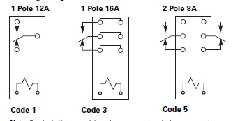

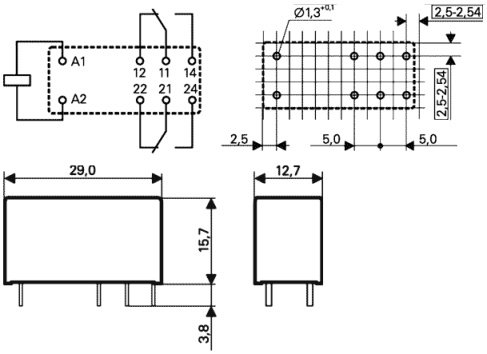

this bellow is the diagram from my PCB Relay RT424012

I don't think you can do what you want with a single button and a relay.
You can wire a relay to act as a 'latch' so that when you push the button it turns on and stays on... but you would need a different button to turn it off.
In order to do what you want, you need a push-on/push-off button, or you need more relays to build a 'flip-flop' circuit with.
dam ok thx. Could you show me how to wire in a way that when I push the buttom it goes off ??? that would be awsome thx
I would suggest using a 'latching' type of push-button instead of the push-button you currently have. This would be the only part you need.
Is you have your heart set on using relays, I've seen a number of 'flip-flop' designs using 3 to 7 relays. You send a pulse to the group of relays and it will toggle the output each time you hit the button.
The design can be quite complicated and you risk short-circuits if wired incorrectly.
