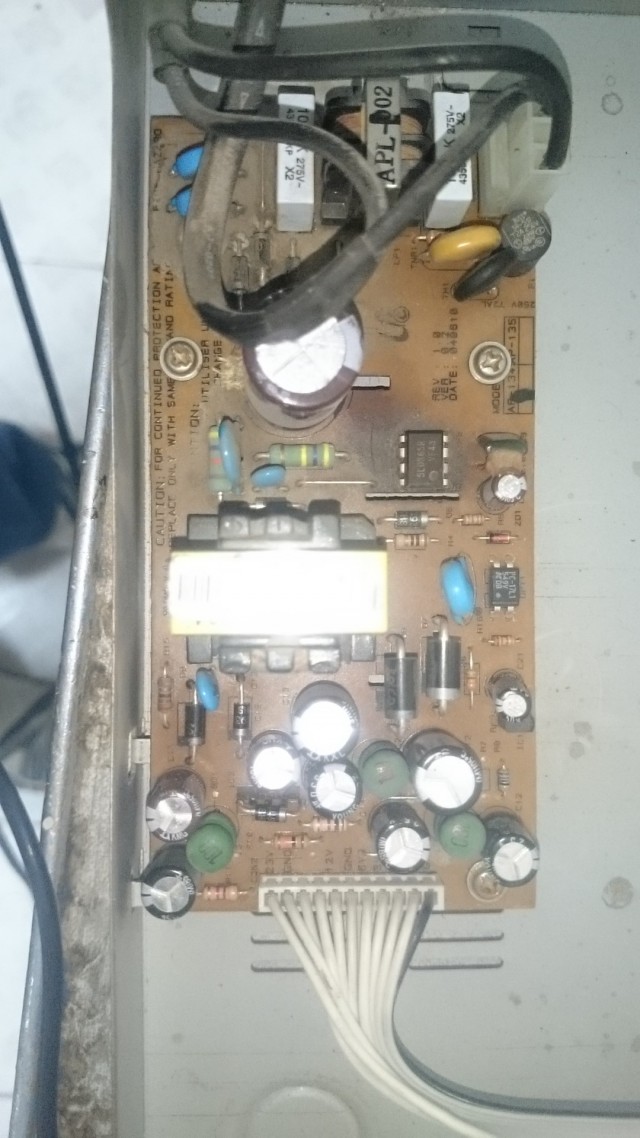

This is what I suspicion . . . . . . over an extended time period of use . . . has happened with that unit of yours . . . .
A RUN DOWN OF ITS OPERATION . . . .
Referencing to the supplied FAIRCHILD tech application note, to then have its reference schematic.
Observing far left bottom corner and rising upwards, you see the origin of the MAIN AC to DC power supply of the unit and it entering into the C102 supply capacitor being across
BLUE A and
BLUE B. The DC voltage is now being upwards of 300VDC, then routes to the right from
BLUE A over to
BLUE C. There is a power flow path from
BLUE C to
BLUE D of the primary of the T101 switch mode power supply transformer . Then there is the
BLUE D connection made to the left to the

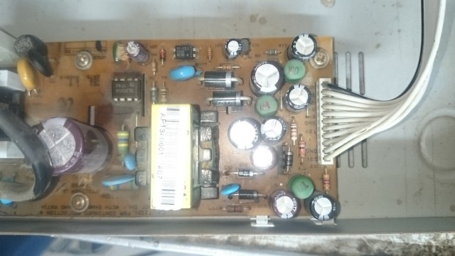

BLUE E connection to the drain connection of an internal POWER MOSFET *** built within the IC proper.
*** ( THIS POWER FET can handle upwards of 22 WATTS, so you can see the long time discoloration effect upon the nearby phenolic PCB area around it.)
All is in order for that power supply to spring into operation . . . . being only less the drive pulses into the FET.
BUT . . . that voltage would have already been initiated, at the instant that the unit was plugged into AC line power.

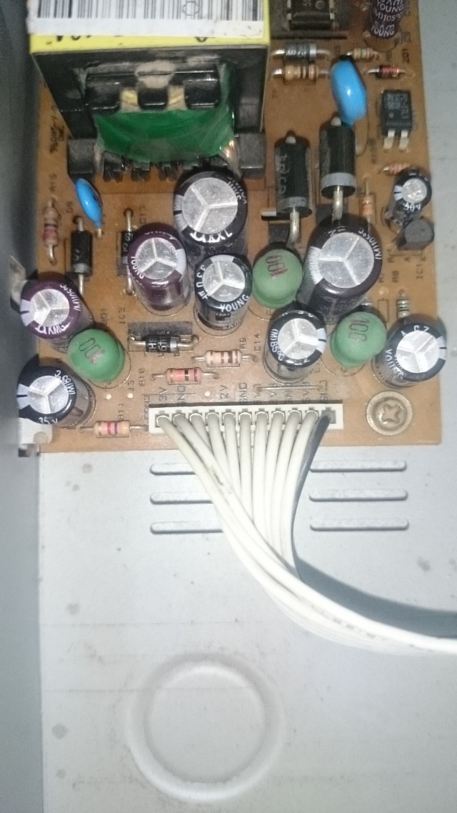

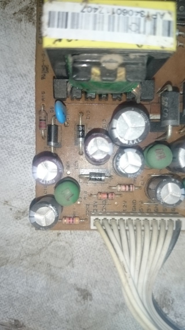

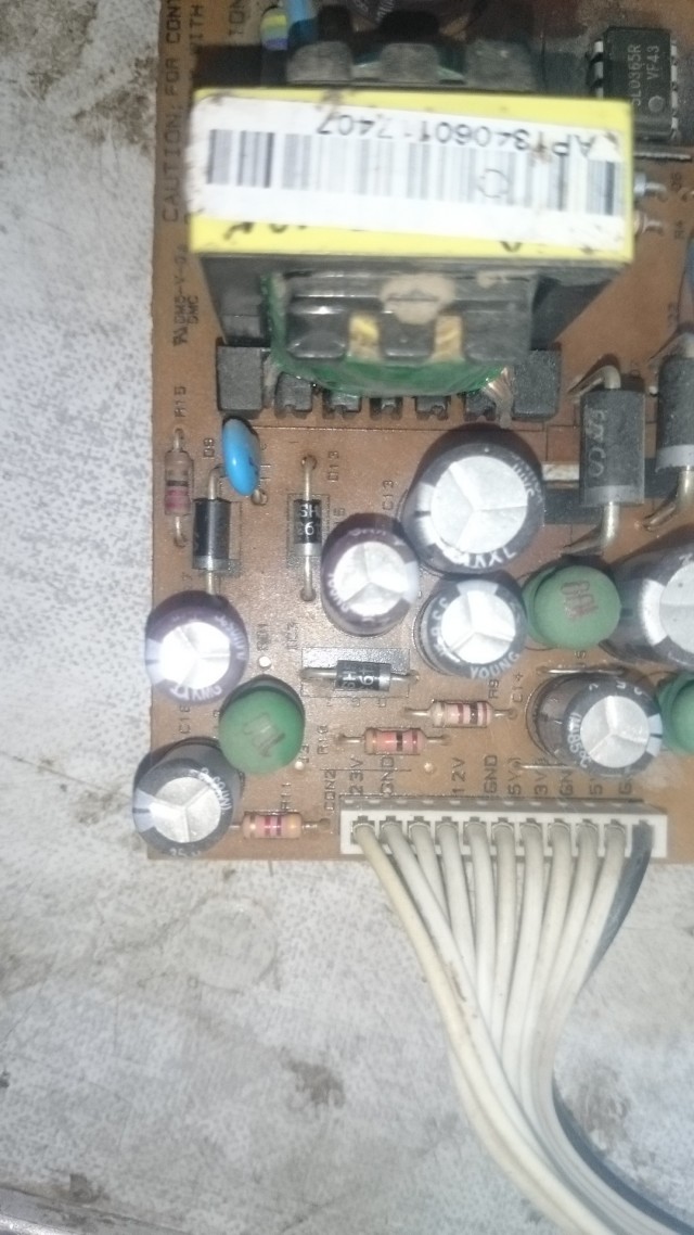

If those
HARD worked filters . . . . .having had the HELL hammered out of them by incoming 10's to 100's of thousand pulses PER SECOND. . . . have not succumbed and are starting progressively dropping capacitance by incremental drying out of their internal electrolyte.
Then, fully expect a gradual on setting of progressive heating to further speed up the capacitance decay process.
Of the suspect C213 and C214 electrolytics of that 5VDC supply, the first C213 is most subject to the hardest HAMMERING, while the C214 receives some pulse buffering by the inline 4.7 ufd inductor.
So, should you choose to test this unit . . . the approved Mac Guyver technique . . . will need you to do this.
Choose your favorite and most used finger upon one hand . . . . . then revert to actually USING the like finger on the OTHER HAND.
Fire up ye olde power supply . . . . . test the temperature of the IC with aforementioned finger until you can
DEFINITELY detect a warming of the units top case.
Hopefully after this warm up time you can then move over to the COLD secondary side of the power supply and do a fingertip temperature test to the top metal caps of each of the 9 caps on that side of the transformer.
At the end, go to the 1 electroltytic on the HOT side of the board near the IC and check its temperature. ( a 47 ufd 50VDC ? unit)
If you find hot ones, solder a like value of electrolytic capacitor across its connections and do a voltage check of your supplies again.
If this gets you fixed . . . . . a MASS change out of all of the electrolytic capacitors would be in order.
