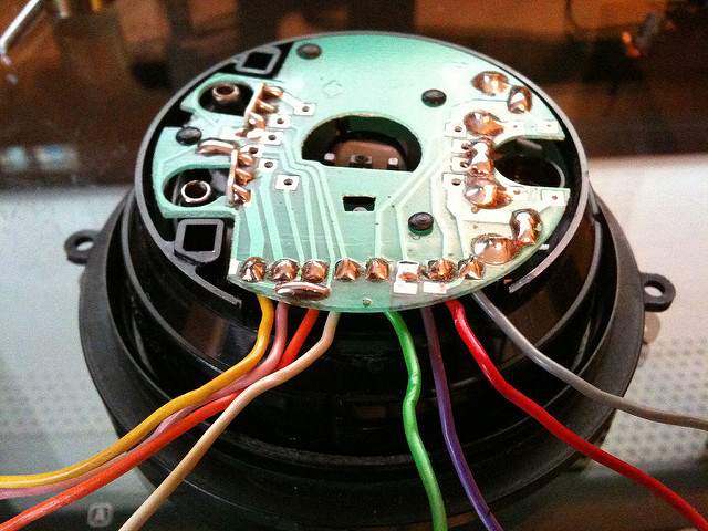

I have a four-wire electrical feed (purple, green, red, and grey) which are designed to power two independent motors in a power mirror motor unit.
  • The purple and green control one motor which pans right/left and left/right dependent on polarity.
  • The red and grey control another motor which pans up/down and down/up dependent on polarity.

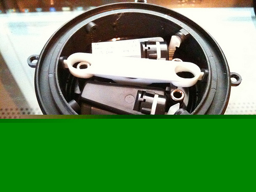

I need to connect these wires up to a different motor unit which has only one motor (black & blue wires) that pans right/left and left/right dependent on polarity. However, this unit also has an actuator (white & brown wires), which has a gear that transfers torque from the standard gearing, allowing the motor unit to pan up/down and down/up dependent on polarity, however, to accomplish this, two wires must be connected to negative and the other two wires must be connected to positive to pan up/down and down/up.

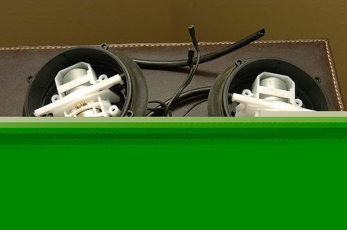

Dual Motor Wiring to Single Motor/Actuator Unit
e31 Memory Mirrors Front
e31 Memory Mirror Motors Back
Non-Memory Mirror Motor Back
M-Tech Mirror Motors Front
