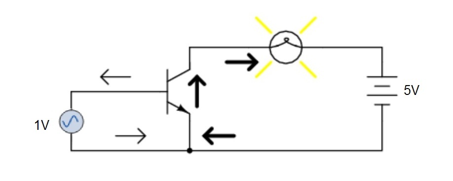

Ok, i'm getting no responses, so a simpler question that will also help. In the common emmiter BJT amp example below, does the 1V signal source see the 5V battery?

As long as the input signal and output +Supply share a common GND, it is no problem to have a 5 or 10 V signal at the gate and a 1000 V power source for the load. The MO in MOSFET is basically a thin sheet of glass rated for the peak drain voltage.
