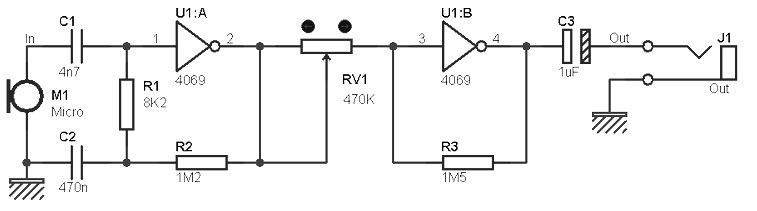

You can use CMOS HEX inverter's as an audio amplifier then with diodes, a peak detector, a Schmitt Trigger and a one shot all in one chip or use an Op Amp, transistor and a 555.

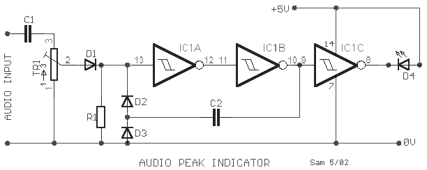

An old link of mine can be simplified without pots, but if you breadboard and want to experiment with a 9V battery
http://www.electro-tech-online.com/threads/simple-led-circuit.145396/#post-1228906 Just remember to add the 14K pullup to your mic. to 9V.
The dotted line above contains all the parts inside the mic. and the outside is V- or ground.
