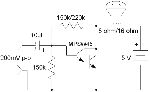

The schematic of my circuit is one like this
With two NPN transistors and one adapted LED that doesn't disturb the power traffic
The comment about the LED doesn't make any sense (especially since there is no LED there).
the 220k resistor should be connected between the base and the +ve terminal of the battery.
This circuit will draw significant power (it's class A) *and* a DC current flows through the speaker (which is generally a bad thing)
edit: google for the LM380 or LM386 (depending on the power you require).
Not necessarily, the way it is shown, it will have negative feedback to stabilize the bias. Otherwise, an emitter resistor is needed.
Edited to add: I don't think you get anything like 200mV out of an electret mic, more like 5mV. And an electret mic needs a power connection, if it is not built in.

The bias resistor can be split into two resistors with their common node bypassed to gnd with a cap. This maintains bias stability while removing negative signal feedback. ;)
