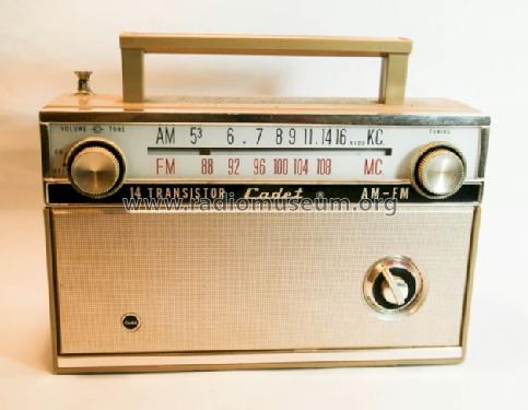

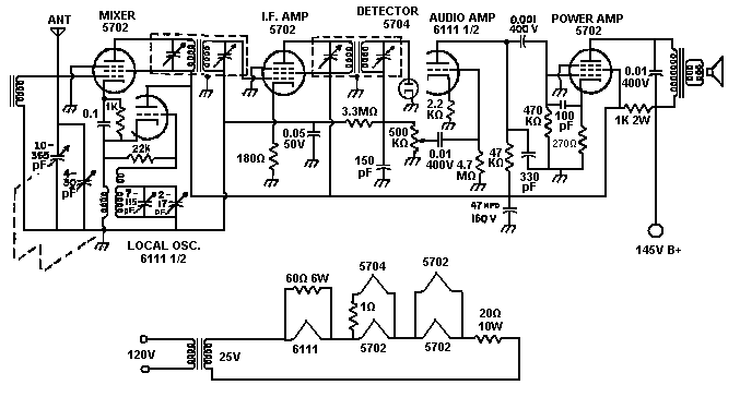

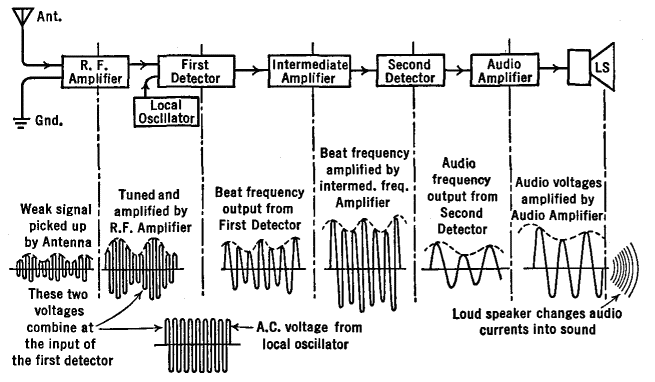

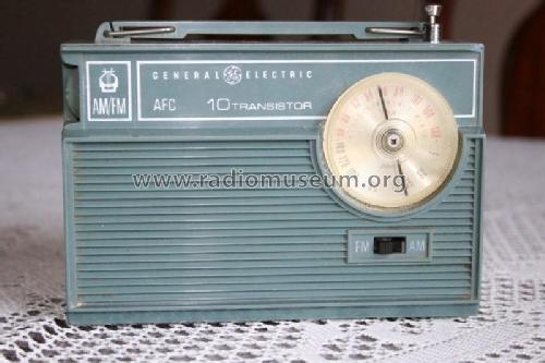

And here some ones with both AM and FM:
That's weird, I see in the last image that the AM and the FM have two completely different circuits, and there are different antenna and different inductors. The AM circuit doesn't even have an antenna really and just uses the MW inductor inside a Ferrite rod as the antenna and the MW inductor has hundreds of coils. The FM circuit has a telescopic antenna and has a VHF inductor with 7 coils.
So I guess I'm wrong, I guess the super heterodyne receiver doesn't let you use the same inductor for all bands. I told you so when I told you that my grandma's clock radio was working for AM but not FM and I opened it up and saw that the inductor with only a few coils was loose and alligator clips worked to make the connection and made FM work. Alligator clips worked for that clock radio when onlry 2 alligator clips were used, but alligator clips should not be used to make every connection in the circuit, in fact alligator clips shouldn't be used to make any connection in the circuit.
As I've stated previously spend some time in our Tutorial section. Also read as much radio theory as you can absorb.

Okay, from the last image I posted, it appears that the super het has the inductors before the down conversion to the IF, and it appears that there is only one variable capacitor and actually both circuits have the RF gain stages on all the time just there is a switch to connect the demodulated RF to the audio amp which is what actually switches from FM to AM since audio frequencies will handle a simple switch with no problems of detuning, correct?
