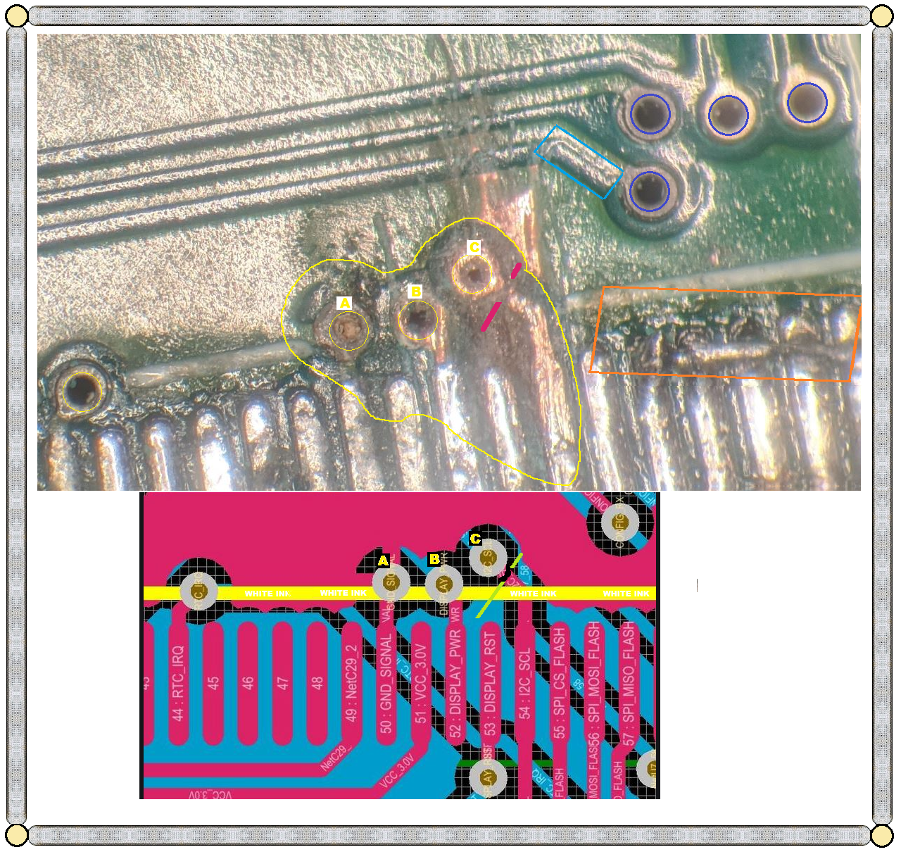

I have a unit that's been operational for a little over a year. Something went wrong and suddenly the LCD is no longer getting the I2C clock signal. Shorting the LCD's pin directly to the I2C SCL pin of another chip gets it working again.
I found a discontinuity between a via underneath the MSP back to the MSP pin. Everywhere else on the line has continuity.
At first I thought maybe the via wasn't properly connected all the way through the board. I lifted the MSP off the board and the via is fine. I carefully scratched off the solder mask and saw part of the copper trace has just vanished. You can see the discontinuity in the middle of the first image linked. The trace to the pin is fine, the via is fine, everywhere else is fine, but between that via under the MSP and the trace to the pin there's a small but clear discontinuity of no more than 25um across the entire width of the trace.
Has anyone seen something like this with a clock line? Trace width is 8mils, should be okay, it's been working for a year. Is this a one-off manufacturing defect, or a likely error in design/manufacturing that I can avoid?
