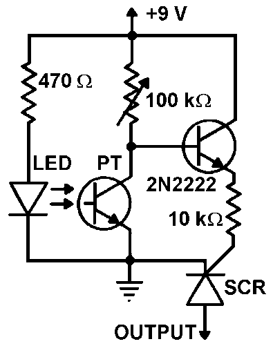

I would like the LED to turn off when beam is broken
Hello,
I would like to include an LED to act as an indicator as to when the beam is broken. It will also be an indicator to when the sensitivity of the photo Interrupter is just right.
There are 2 outcomes for the LED:
1 - when the beam is broken, the LED will go out, and then back on when the beam is established.​
2 - when setting the sensitivity of the photo interrupter, the LED will go out when the resistance is too high, then when I back the pot off, the LED will come back on.​
The relevant parts of this schematic include the Photo Interrupter (The photo transistor and its associated led), and the 100k pot, (which I will change out to a 10k pot). You can ignore the 2N2222 and the SCR as the output of the Interrupter will be going to an Arduino to trigger an event.
Any help is appreciated. Thx.
