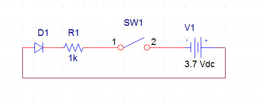

I drew this diagram. The R is a resistor for the LED, the circle on the right is the 3.7v component.. I need the led to turn off only when that component is on/ when the momentary switch is pressed

I don't really know if this is the kind of circuit you want...
In any case, as far as I can see, the LED would turn on depending on the value of the resistor AND how you place it (cathode/anode). I don't understand the question or if this is even the circuit you're trying to draw though :(

If you look at my diagram, the led will always be on.. How can i make it turn off when the switch is closed and have it turn on again as soon as the switch is opened?
Hope this makes more sense?
It's much easier than all that. First you need to know how a diode works. Check this link:
http://electronics.stackexchange.com/questions/54977/how-does-a-diode-work
I don't really know what kind of circuit you have and why that diode is on even though it is not conected to the network, but in a nutshell, you have to make the current flow in the other direction. That is, connect the voltage source so that when you press the switch the current flows "against" the diode. Does it make sense?
In any case, if you send the squematic of the whole thing it would be much easier to help you and give you a complete answer (an squematic is something like the one I uploaded earlier).

Woow thanks! I think this is what im looking for.. I will try to replicate that circuit and let you know.. would you be able to tell me what kind of diode id need? shall i just type 0.7v diode in ebay?

As 2 other people have already suggested, you can leave the diode out in Dorke's circuit and it will work just as well.
And there is an even better solution. Use a normally closed pushbutton in series with the LED, resistor and battery. Pushing the button then breaks the connection and the LED is off without drawing any current like the other suggestions would.
CDRIVE
Bob's suggestion is the best way to go in our energy conscious world.
