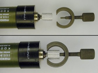

Use a bearing/pulley removal tool such as this .........on a smaller scale obviously

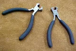

A pair of pliers using the "cable cutter" section will work equally well.
Jaws sneak in between rear of the gear and the motor.
Key to success is a fine enough punch tool to fit inside the gear and suspend the motor/pliers combination over a set of vice jaws.
Oh...AND you'll need a small hammer and extra set of hands to boot. :cool:

The gear pullers are godd if there is space behind the gearwheel to get the clamps into. From Fuzzylogic's photos I take it that the gearwheel almost touches the motor housing., It will be difficult to get any sort (solid) of clamp in between gearwheel and housing, Unless there is enough clearance between axle and housing such that the gearwheel can be pulled forward far enough for clamps to grab behind it.

Yes, the pinion gear is butted close to the bearing, making behind-the-gear shaft access impossible.
However, as I've already made a deep, v-shaped groove in the gear, I'll cut / grind a v-groove in a 40 mm x 4 mm piece of steel flat-bar.
Using @Bluejets 's idea of a bearing clamp, the "groovy" flat-bar will wedge snugly into the pinion gear's groove, the flat-bar being laid across open jaws of my bench-vice, motor housing suspended loosely between jaws.
For a striking "pin", I'll first tap a large nail from top, then maybe a small jeweler's screwdriver tapped in to finalize extraction.

Use the bearing puller in the groove you have already made.
You can get nut spltters and it should be a doddle to split brass.
