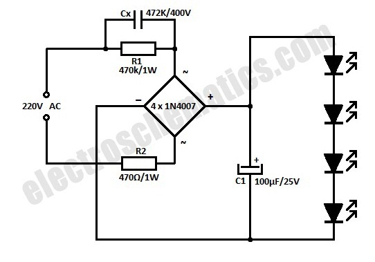

That circuit is called a capacitor-fed power supply. The reactance of the capacitor converts the AC voltage to a current that charges the reservoir capacitor and powers the LEDs.
These power supplies are not isolated and are an electric shock hazard. They may only be used when the entire circuit, including the load, is fully isolated and contained in such a way that it can't make contact with anything conductive, and especially, that no person can touch it.
These power supplies also have a fairly limited output current capability. They are not suitable for general use. They are only usable in specific situations where the whole product is fully contained and isolated, and there are no external connections to it.

duke37 is pointing out two disadvantages of having C1 present.
The four LEDs in series clamp the votage across C1 to about 12V (depending on the LED type). If the LED path goes open circuit (a failure of any LED or a break anywhere in that path), C1 will try to charge up to about 310~320V DC and if it's rated at 25V, as shown on the diagram, it will explode. In other words, that circuit is not just an electric shock hazard and a fire hazard, it is an explosion hazard.
Secondly, the circuit will work almost as well without C1 anyway. C1 is there to smooth the LED voltage and reduce the flicker, and increase the average brightness somewhat, but these benefits are small and C1 may not be justified.
The important thing about this power supply is that it is dangerous because it is not isolated from the mains, and it must only be used in a fully enclosed product with no external connections.

The presence or absence of the 100 µF smoothing capacitor doesn't change the fact that the circuit is not safe, as I described in post #2.
Edit: Using a 400V capacitor will stop it from exploding if the LEDs get disconnected, but if they get reconnected (for example if there's a dry joint or loose wire), the LEDs will be destroyed instantly.

now on your schematic you could replace C1 cap with a 5 volt zener. (what do you think avout that chris?)
`C1 is not necessary, many led displays are multiplexed and have a pulsed supply. If you wish to smooth the current in the leds, then a resistor would be needed to run C1 appreciably above the led voltage.
Putting a 5V zener in place of C1 may not work. The supply is current controlled. If the leds need more than 5V, they will not light, if they need less than 5V then the zener does nothing.
LEDs do have some internal incremental resistance so the capacitor will have some effect. I ran a simulation to find out, but I had to change "CX" to about 0.47 µF (not "472", i.e. 4.7 nF, as shown in the original schematic, which I assume is a typo) to get significant LED current. LTSpice doesn't have a great range of LEDs. The LEDs I used in the simulation, type QTLP690C, appear to be pretty standard red LEDs.
I ran the simulation with C1 = 100 µF, then again with C1 = 1 pF (LTSpice doesn't like capacitors with zero capacitance, but 1 pF is close enough!)

In both cases, the mean LED current is 28.4 mA, but the ripple is obviously reduced quite a bit with the capacitor in circuit, so the blinking effect is definitely reduced. Whether or not this is visible will depend on the application.
Agreed!
Hello KrisBlueNZ.
I have seen schematics like the one on your post #12 many times and places on the web.
I do not understand why the components D5, D6, D7, D8 are not fully erased/deleted from the circuit; and make D1, D2, D3, D4 the LEDs instead.
Same for the original poster circuit, no C1 either. And 1 uF may be too much for 230VAC on ~20mA LEDs. I would use 0.1 to 0.33 uF
Do you have an explanation ? Sort of that is the way I did my house ceilings 'night lights' , the LEDs as light emitting full wave rectifier, and work superb for years across the wall switch.
And, why is there a grounding symbol ?
The main reason is that only 1/2 of all LEDs would be on per half cycle of the mains sine, thus effectively halfing light output for a given number of LEDs.
This is required by the simulator as 0V reference point. It has no practical relevance. But voltages are differences in potential energy and since there is no absolute 0V reference potential, you need to supply one to the simulator. You can place the GND symbol (almost) anywhere in the circuit.
What Harald said. Each LED would only illuminate for a maximum of half the time.
Also, LEDs can't be used in a bridge rectifier generally because they will be damaged by a reverse voltage of more than about 5V. But what you're suggesting is a bridge rectifier with its output shorted out; this is really just equivalent to two LEDs in series, and another two LEDs in series, connected in reverse parallel. So that won't exceed the reverse voltage specification.
I used 0.47 µF and got a mean LED current of 28.4 mA. That's too high for 20 mA LEDs but the application is lighting, not indication, so LEDs are normally rated for more than 20 mA.
As Harald said, it's only needed for LTSpice, the simulator. Without it, LTSpice goes haywire and throws up all sorts of crazy errors! It definitely does not correspond to mains earth! It's not actually a ground symbol anyway.
