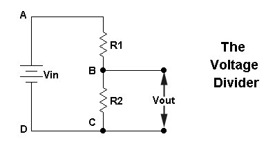

I was going to do one of those "voltage networks" using Vout = Vin(R2/(R1+R2))
But, You still need a source to calibrate it. And I also wasn't sure if the current would be enough with the resistance values there.

I would like to make a voltage divider.
I have the basic Idea
I really just need to know what the input impedance of the DMM i have has to do with anything. its 10Mohms. Where does it go in the calcs i need to do.
I suppose R2 would be a variable Resistor to fine tune what i need.
Electric fence energisers are rated in energy/pulse, 5J is about the maximum and I keep well away from that. The pulses occur once/sec so you have time to withdraw. I assume that your device is also pulsed so measuring with a DVM would not be possible. Adding a rectifier and capacitor to give a measurable voltage would risk exceeding the permitted energy. To measure the voltage dynamically you will need to use an scope. Your divider could consist of nineteen 1M resistors for R1 and one 1M resistor for R2, You do not need anything variable and if the resistors are 1% you will get an output of 5% of input. You will need ensure a comon ground to C. I think high voltage scope probes are available to measure TV voltages. Do you need high accuracy or will a spark gap do?
Electric fence energisers are normally rated by the energy in a pulse. 5J is the recommended maximum but I keep well away from one this powerful. The pulses occur about once per second so you have time or are forced to withdraw. I could not find what the energy in each pulse is or the repetition rate.
I assume that the output is pulsed and, if so, a DMM will not measure voltage correctly, you will need an oscilloscope. The voltage divider could have R1 as a chain of nineteen 1M resistors and R2 a 1M resistor giving a division ratio of about 20:1. These should be placed in a plastic tube and a good connection to ground made to C.
I believe that such probes are available to monitor the high voltages in TVs.
