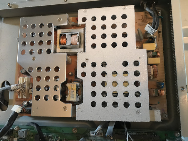

I’ve opened the TV and everything looks “normal” (to my very untrained eye), except for half of the power supply board (mostly the thick metal “scaffold”, possibly called the heatsink??) is coated in a white dust.

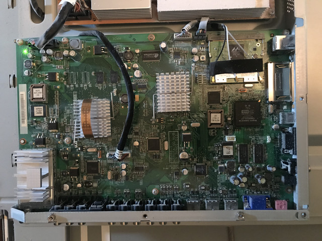

I plugged in the unit and checked the backlight (both using the torch/flashlight method) as well as looking for any light bleed through from the back of the TV. Unfortunately, I did not see any picture at all with the torch method, and also did not see any light bleed through from the back. So I have a feeling that not only is my backlight out, but I also might not have any picture generated on the LCD screen. One other piece of evidence that points me to believe that I have an issue in addition to the backlight is that I tested the ability for my computer to send audio to the TV speakers through an aux cable (audio jack). I tried cycling through the inputs but no input resulted in any audio output from the TV speakers.
There seem to be 2 separate backlight boards on either side of the TV (not pictured).

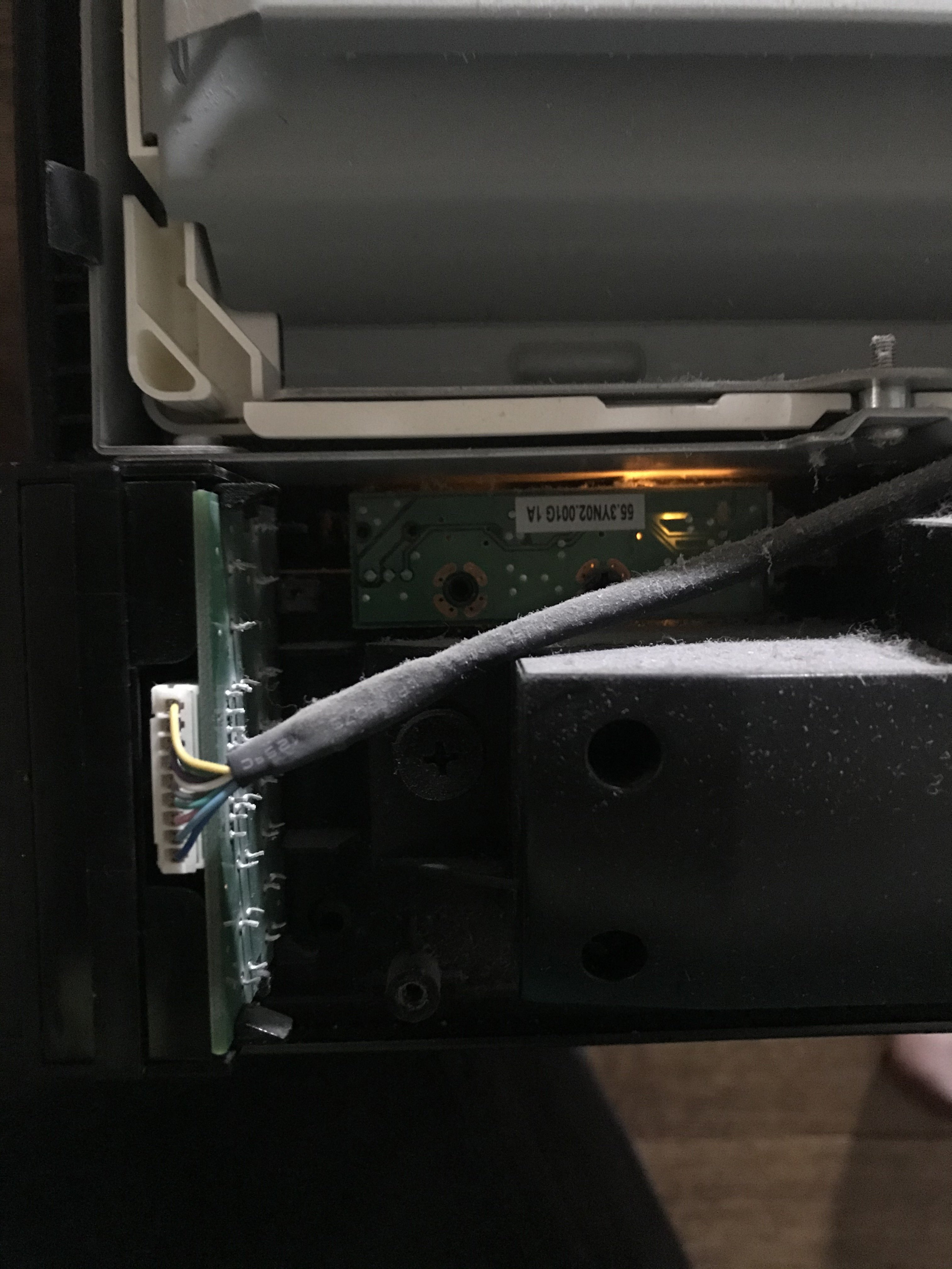

Orange power light changes to blue when turned "off"/"on standby".
Green light on Main Board is on when plugged into power outlet.
https://ibb.co/Svdh61r
Power supply board has white "dust" covering one half of the heatsink (not sure if on the "hot" or "cold" side):
Please let me know what the next logical step would be in determining which board(s) to replace, or where the issue is. I have ordered a multimeter which will arrive tomorrow in case I need to test current flow to/from various components.
