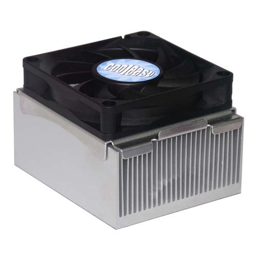

And also how much heat I have to expect from the 100W LED? If I use pc cooler like this will that be enough? Im guessing I don't need extra heatsink for the driver since it already have one.
Assume you'll get 10W of heat from the 10W LED and 100W from the 100W LED.
Then decide on the temperature you want to be thge maximum that the LED will operate at. Let's say you pick 75 degrees C
Then determine the maximum ambient temperature that the unit will be exposed to. Let's say it;s 40 degrees C.
The difference is the temperature rise you have to play with. In this case it's 35 degrees C.
Divide this by the LED power. So, for the 10W LED you will get 3.5 degrees C per Watt.
Heatsinks are rated in terms of degrees C per Watt. You need to find one rated at (or preferably a little better than) 3.5 degC/W.
If the ambient temperature will only occasionally be 40C, then this may be sufficient. If it will *always* be 40C then you should allow extra margin (lower degC/W rating) to allow for dust build-up on the heatsink.
For the 100W LED, this calculation This would be enormous, unless you go for a forced air solution. The one you show above is probably what you're after (and I've seen similar used for 100W LEDs).
The problem with dust is far greater for forced air heatsinks. For maximum reliability you may wish to have a thermal sensor on the heatsink that will reduce the LED current if the heatsink ever gets too warm. (better a dim light than a dead LED and no light at all).
p.s. that device you show above *is* a heatsink. The metal plate that the LEDs are on is simply a way to efficiently get the heat from the LED die to the heatsink.
