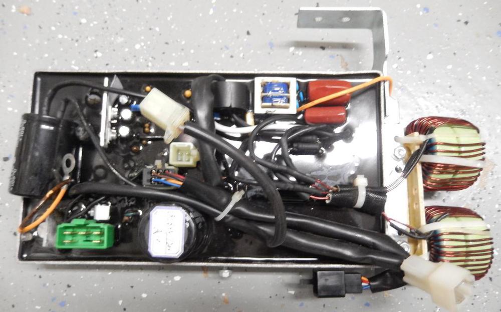

Can you post a picture of the inverter module?
As with many switched-mode type circuits, capacitor faults are high on the 'problem' list and since some of them stick out above the epoxy filling you can (1) spot the faulty capacitor (bulging/cracked top) and (2) 'dig' them out and replace them as you can get access to the leads through the body of the capacitor itself.
The small capacitors look OK. One of the large ones seems to have a bulged end.

Certainly might look that way.
More definitively . . . . . .has it split right at the very center of that stamp distressed metal triad apex ? , and can you get a very small gauge pin / needle down into the crack ?
If so, you have lost sealing, along with electrolyte and a resultant dry out and severe drop in effective overall capacitance . . . . possibly, it now only being mere micro farads.
No potting visible . . . as far as i can see downwards in your photo . . . . possibly its only having a THICK conformal coating on the board . . .Ug g g g g g gh !
Go get em, tiger !
OOPSIES ! . . . . . .looks like it is being potted city . . . .
I see at least 5 E-caps and possibly two more to the side of the laid on its side unit.

Sadly the pics don't help - I thought it might be possible to see something I recognised as a potential problem however the iniquitous black 'gunk' has always thwarted such efforts.
Looks like you're going to be seeking a replacement part.
