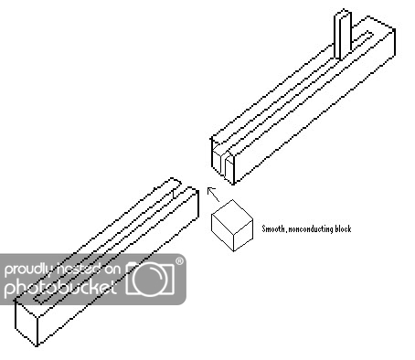

What about instead of a circuit to do this, go for a mechanical solution.
Get a hold of a couple slider-style var pots.
Tear apart one end of each open, so that the slider can come out. Discard one slider, and attach them so that the remaining slider can glide from one track to the other. You'll have to bridge the tracks, too. I think there would be a low resistance stip(metal) and a high resistance strip(maybe carbon) and you'll have to build an insulating block for the slider to ride on as it jumps from ine to the other.
