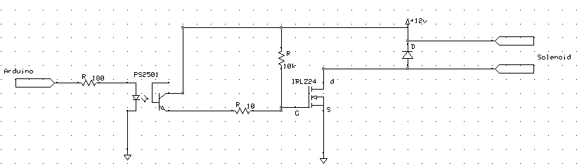

Hey Fish. I know this has been a while since this was posted, but I finally had time to look at this again and start working on it. After re-reading everything and looking everything up again this is what I came up with. Is this what you were talking about?
Please excuse the incorrect symbols for the optocoupler as I could not find the correct one.
In addition to this you need a resistor (about 10k) between the mosfet's gate and source to ensure it turns off
edit: Oh, and you also need a resistor to limit the current from the arduino. Around 180 ohms should be right.

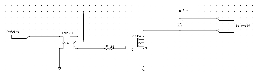

I appreciate the reply Steve. I have made those changes here:
In addition to the diode across the solenoid should I be putting an additional zener diode near the mosfet? I was doing some reading and found others were doing this to add protection to the mosfet. Another reason they were using the zener was to protect the output pins of the Arduino but since I am using the optoisolator I shouldn't have to worry about this correct?
The 10K resistor goes between the gate and the source (ground), not to 12V. The way you show it the FET will always be on, not what you want. Its purpose is to discharge the gate charge when the optocoupler turns off, so the FET turns off as well.
You may not need the 10-ohm resistor. It will slow down the switching time a tad, causing the FET to dissipate more heat.
The zener you mentioned would go between the gate and source (in parallel with the 10k resistor), to protect the gate from voltage surges (load dumps) which in a car can be 60+ volts, while most FETs have a max Vgs of around 20V. A 10-15 volt zener should be fine, just keep it well below the max Vgs of the FET you're using.

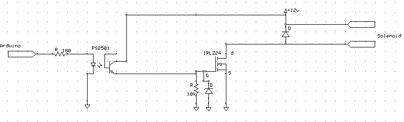

Wow people are replying quick today. Thanks a ton kpatz. I have fixed my schematic:
I removed the resistor from the gate. I plan to order the parts tonight so just trying to make sure I have everything laid out as it should be.

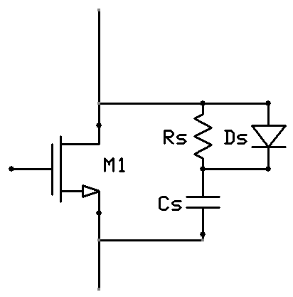

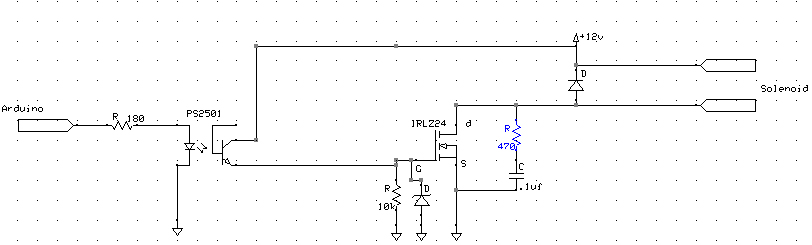

kpatz I just noticed I missed the end of your post there about the snubber circuit. I looked it up and here is what I have:
I noticed some people putting a diode in parallel with the 470ohm resistor. Is this just an additional precaution?
Here is the example I saw:

I recommend the gate resistor as it will limit current through the zener. Without it, you would probably kill the optocoupler if you get a large enough voltage spike.
remember that the opto will probably only permit a relatively low current, so a 100 to 270 ohm resistor would be fine.
Remember you're using a 10k resistor to turn the mosfet off, so the dissipation during turn on will not be the limiting factor.

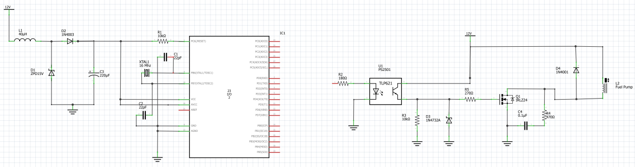

I guess one thing I overlooked throughout this entire project is the power source for the Arduino. I plan to use the ATMega328 in a standalone format with the Arduino bootloader on the chip. I had planned to power this from the bike itself (this fuel pump is going on a bike). It uses a normal 12v battery just as any other motorcycle does. I will have it connected through the ignition switch.
What considerations do I need to take with that? I assume I will need some kind of protection circuit for the arduino to protect it from power surges from the bike.
Steve, After reading over the datasheet that you linked above I am seeing a maximum gate voltage of the FET to be 10V? Does that mean I should be using the Arduino voltage to turn on the FET instead of the 12v? As the circuit is setup it is using the 12v to turn on the FET. Here is the most recent schematic I created:
I am thinking that the 12v will be too much for the gate voltage.
