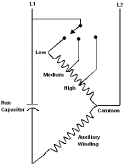

I'm guessing the configuration is something like this for the three speeds:
Your readings certainly correlate with 215Ω 's as being the auxillary winding resistance.
If only having that .47 poly X type cap, I would certainly venture shunting it across the run cap and then putting the unit in HIGH speed and giving the fan / impeller / shaft a spin in the CORRECT direction.
If still just a HUMMMMMMMMM, pull / disconnect the original capacitor out from circuit and then just SOLELY use the sub capacitor and go thru the same procedure again.
