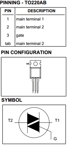

MT1 and MT2 . of the units power control which utilizes a BT139-600E Triac.
It 'soitanly wouldn't hurt, to have a GOOD SHARP closeup photo of the foil side of the PC board
if any further help is being needed .
BT139-600E TRIAC:
