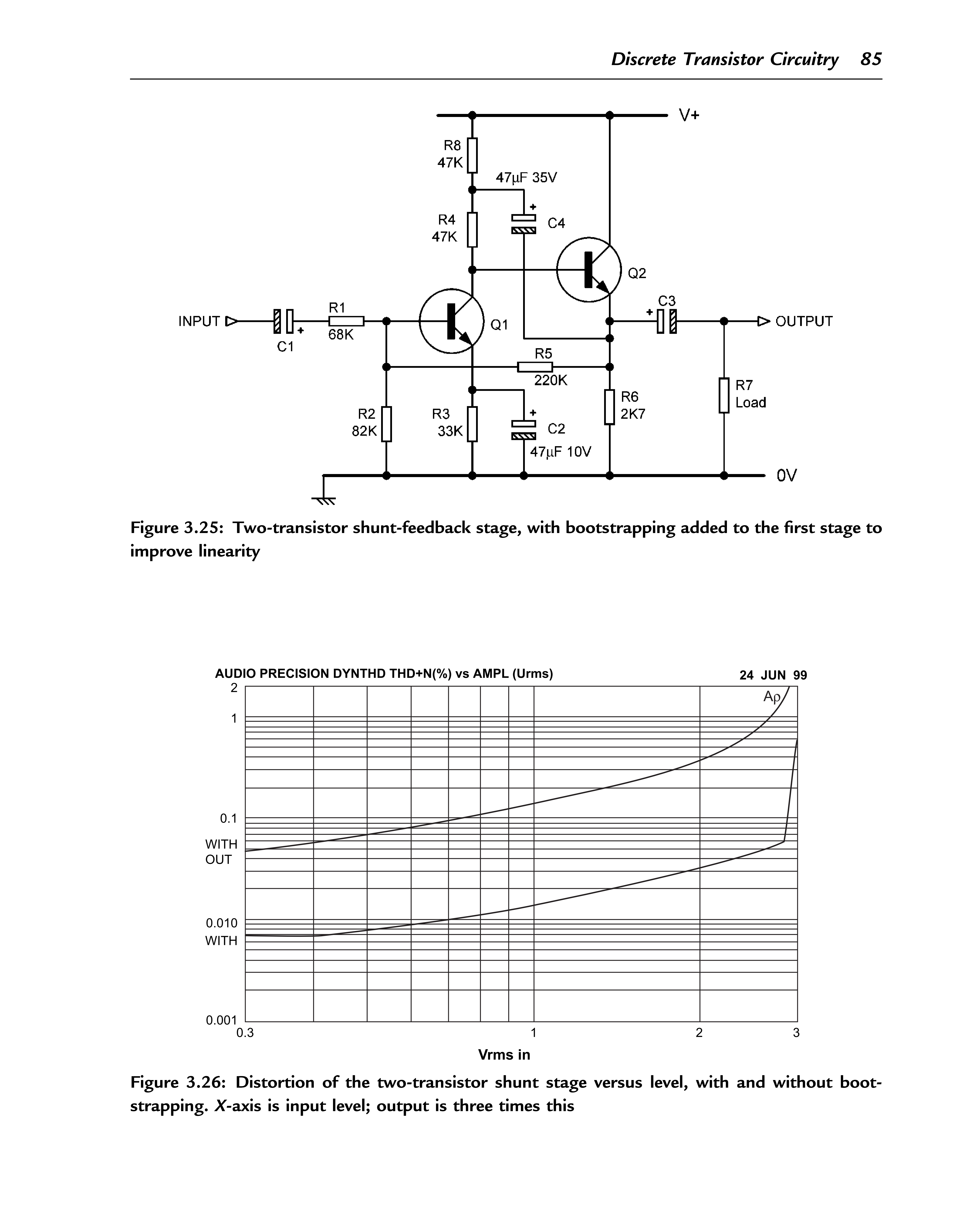

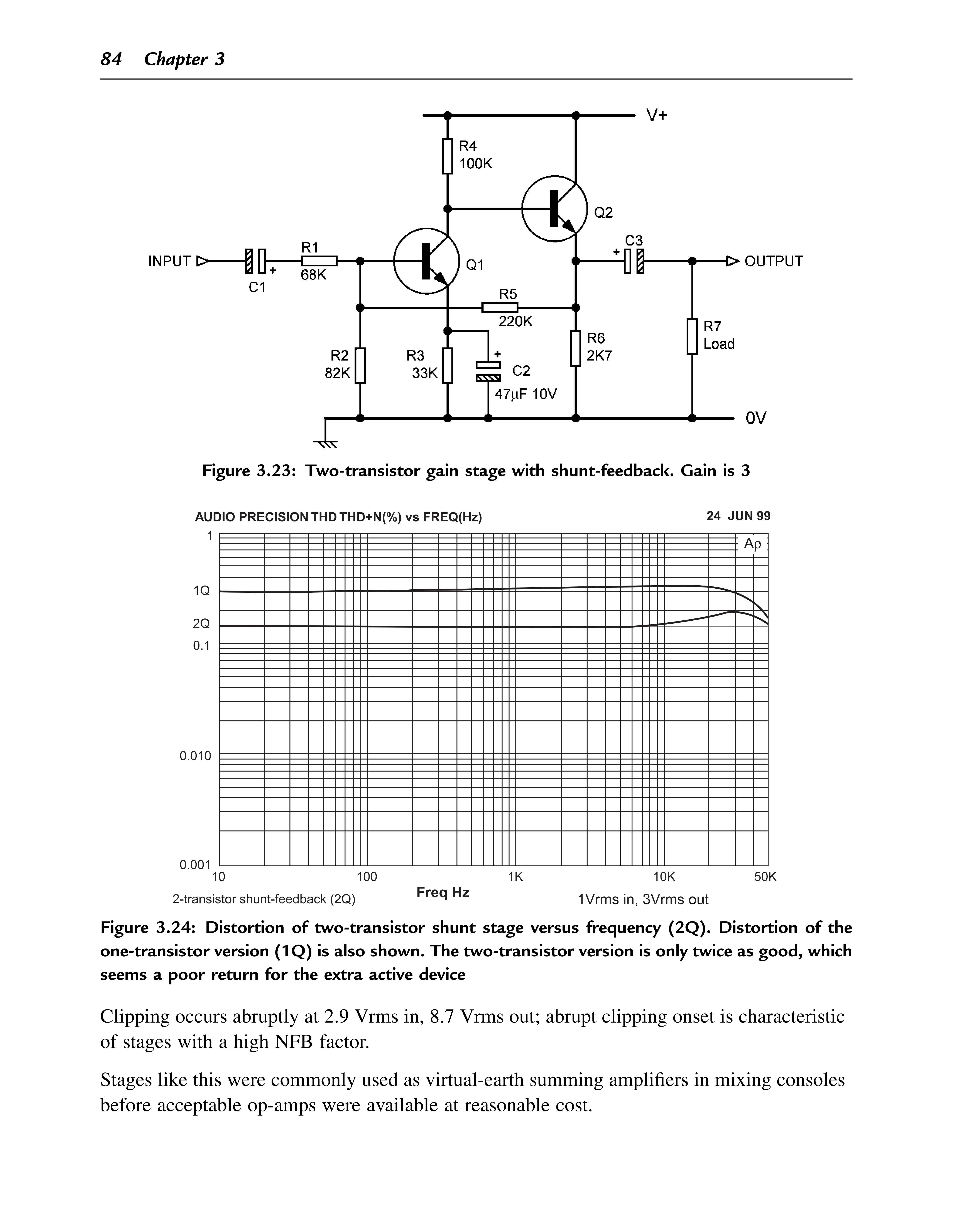

Just found this on page 85 of "Small Signal Audio Design",
2010, by Douglas Self:
V+
/ R4
\ 47k
| C2
| || 47u
| | V+
/ R2 | |
\ 47k | |
| | |/c Q1
| | |>e
| | | C1
| | +----||----+--OUT
C4 | | |
|| R6 |/c Q2 | |
IN---||----/\/\--+------| | |
|| 68k | |>e | \
| | | / RLoad
| | R5 | /
| | 220k | |
| | | | gnd
/ R7 \ | \
\ 82k / R3 --- C3 / R1
/ \ 33k --- 47u \ 2.7k
gnd gnd gnd gnd
Described as a 2-transistor shunt feedback stage with
bootstrapping added to the first stage to improve linearity.
Jon

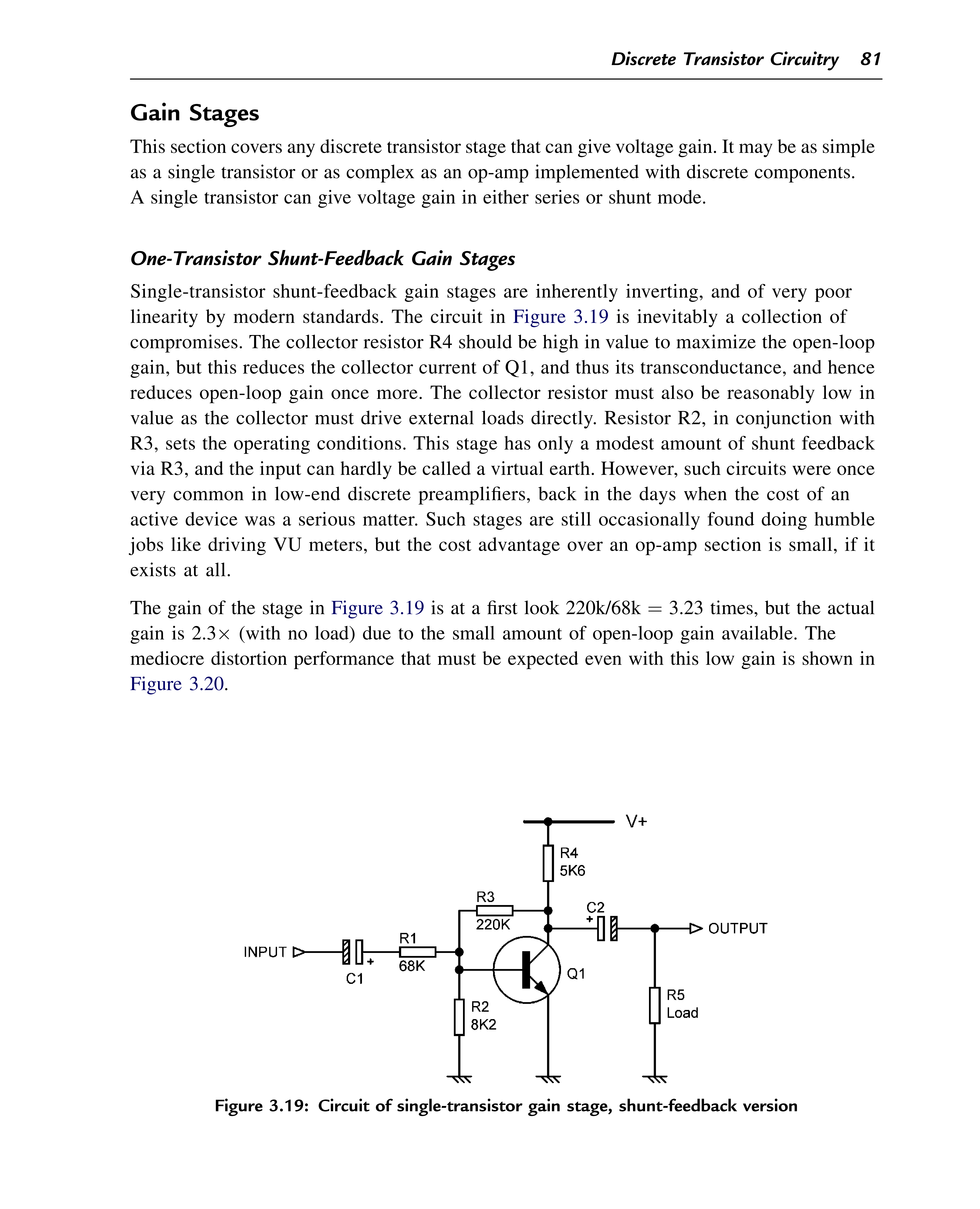

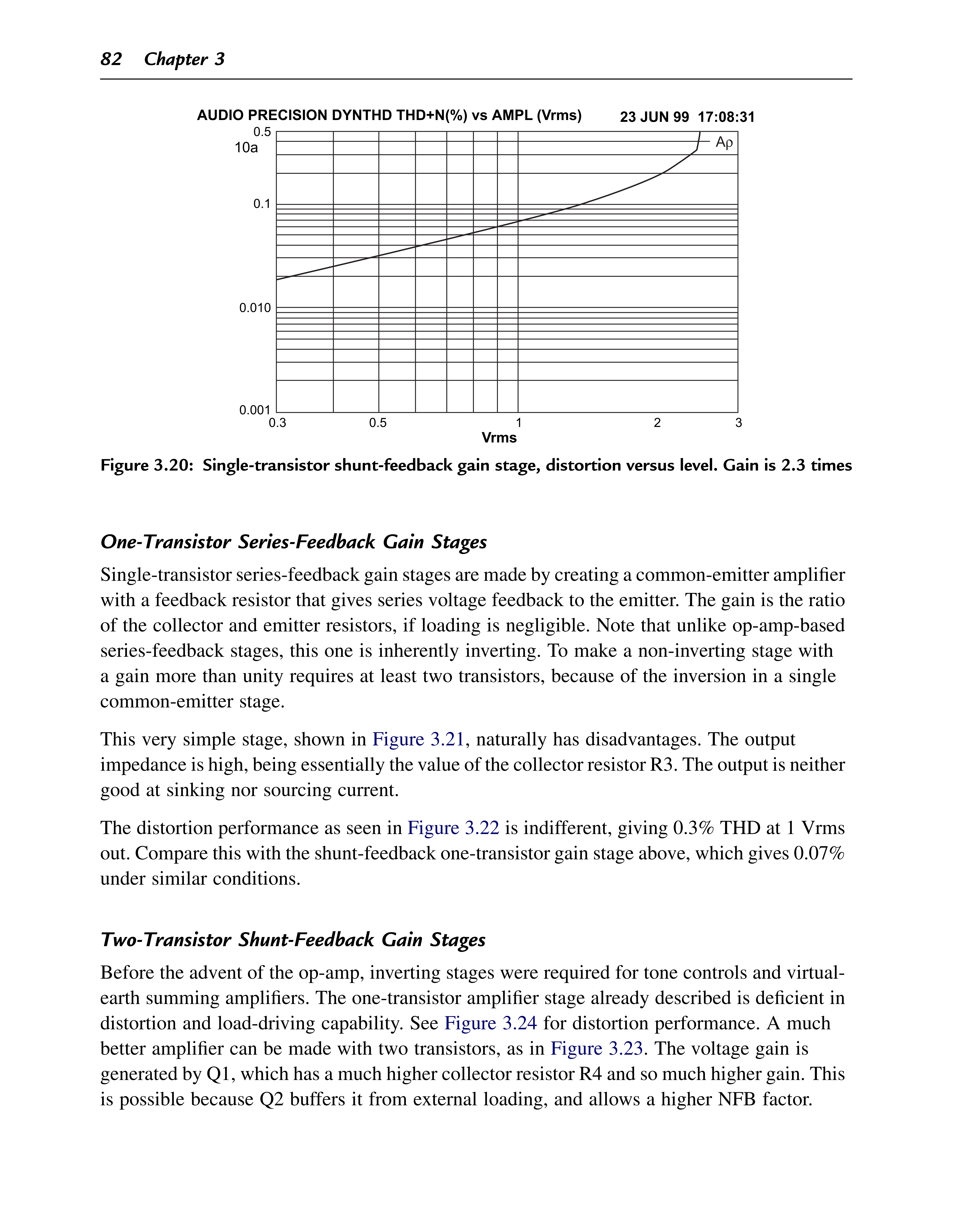

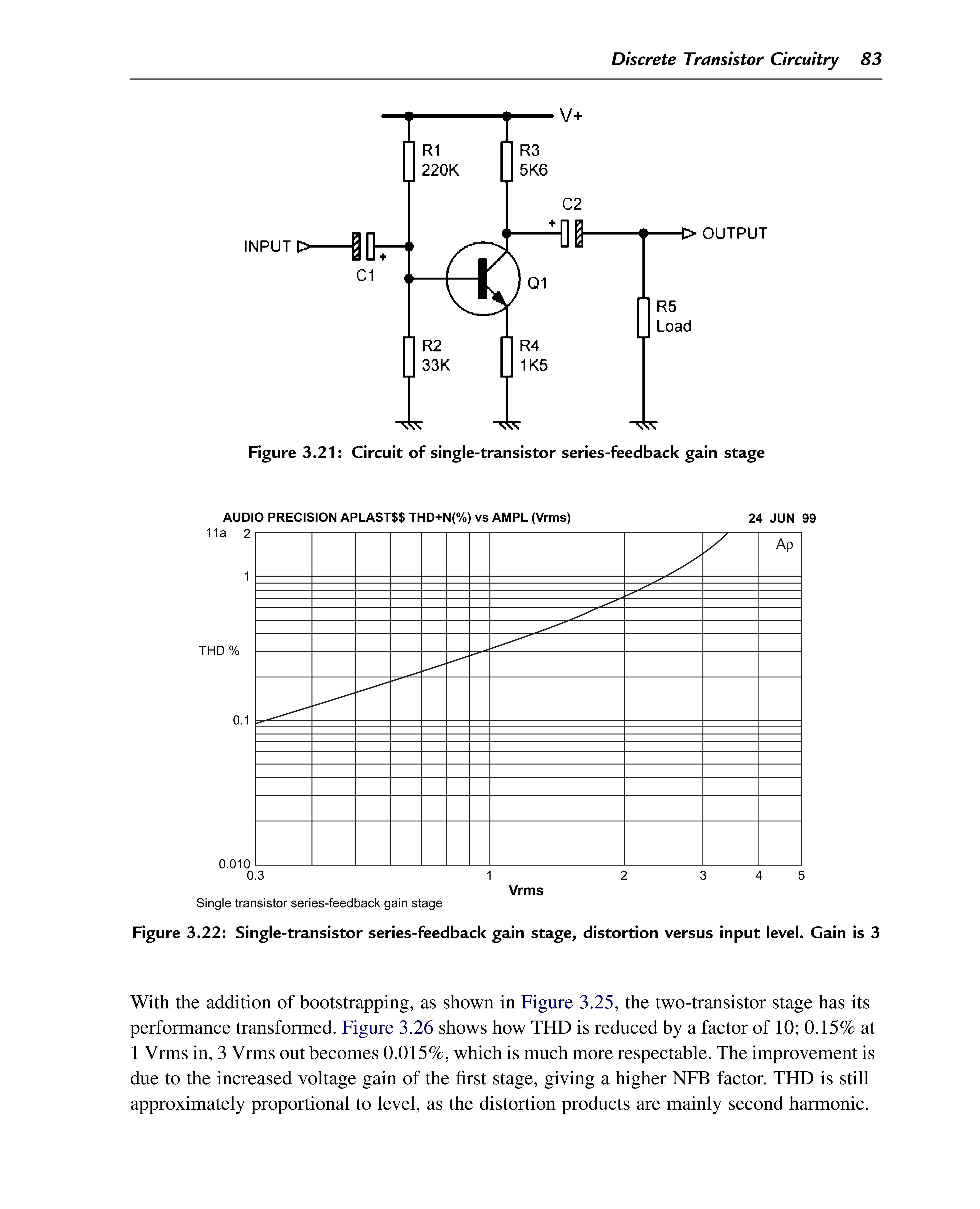

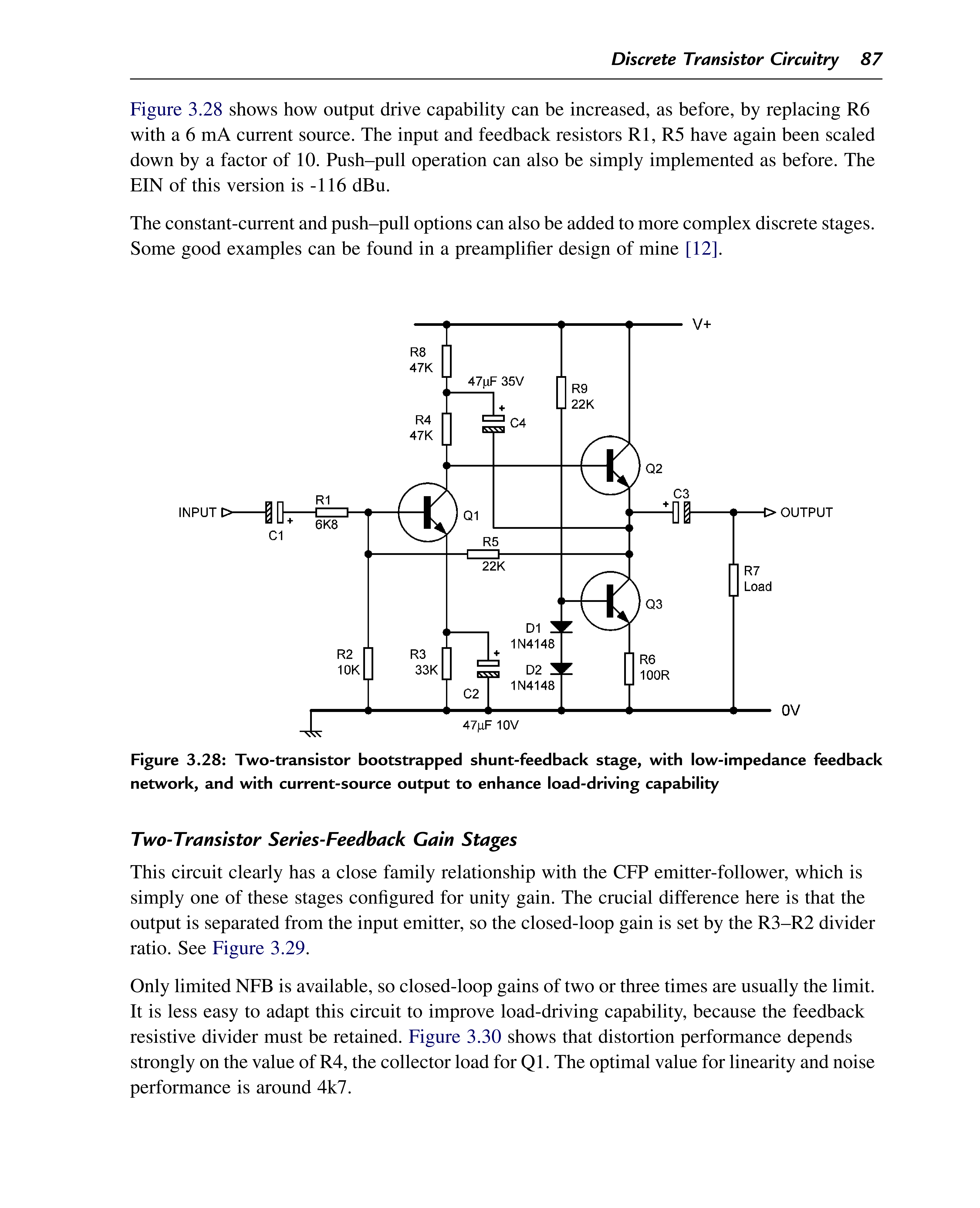

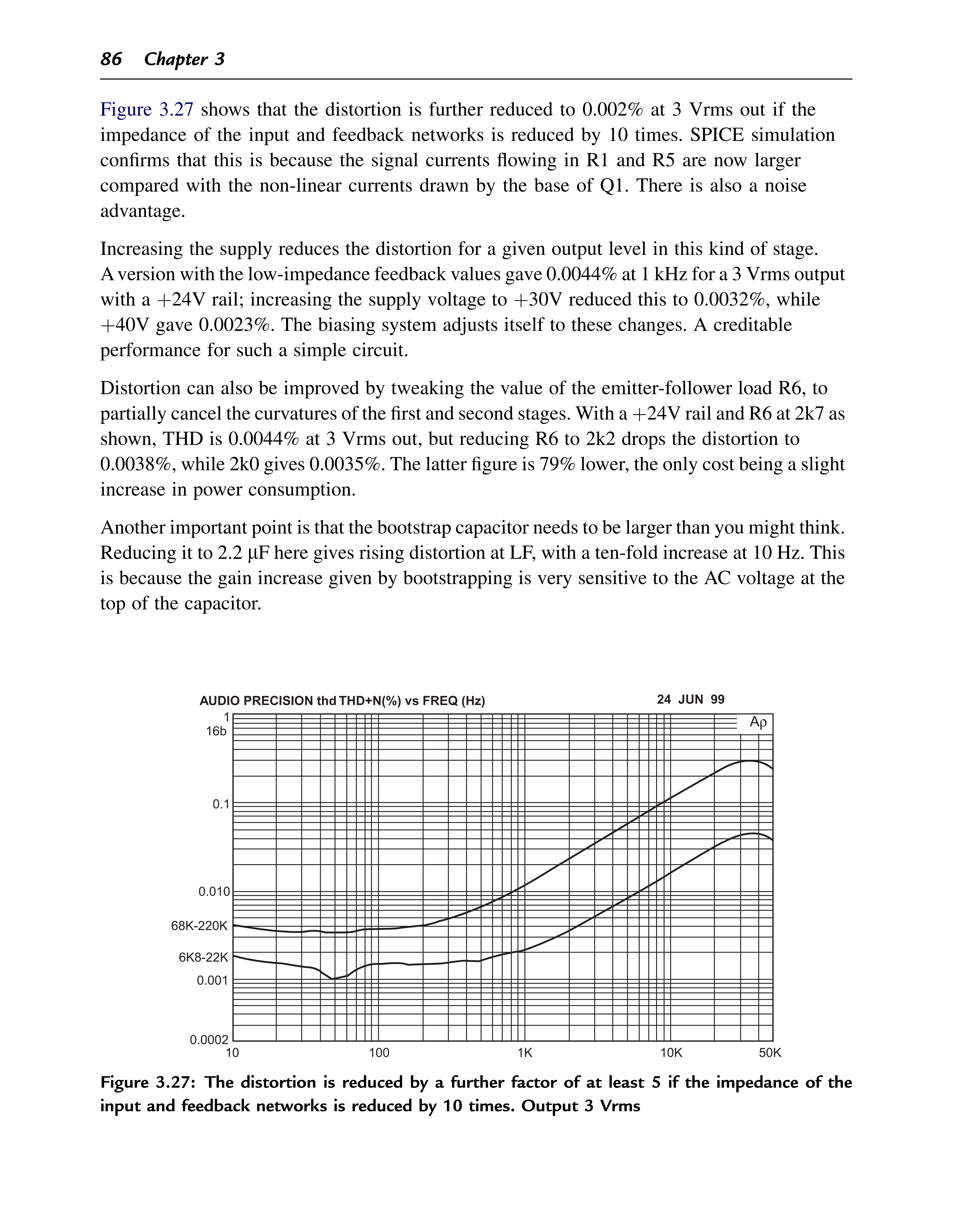

Here are links to the surrounding pages of Self's book. The
gain is supposed to be about 3 in all cases, I gather. He
starts with a simple amp and makes incremental mods,
displaying some graphs to illustrate the discussion:
http://www.infinitefactors.org/docs/Small-Signal-Self-p81.png
http://www.infinitefactors.org/docs/Small-Signal-Self-p82.png
http://www.infinitefactors.org/docs/Small-Signal-Self-p83.png
http://www.infinitefactors.org/docs/Small-Signal-Self-p84.png
http://www.infinitefactors.org/docs/Small-Signal-Self-p85.png
http://www.infinitefactors.org/docs/Small-Signal-Self-p86.png
http://www.infinitefactors.org/docs/Small-Signal-Self-p87.png
http://www.infinitefactors.org/docs/Small-Signal-Self-p88.png
I think this is fair use of the copyrighted material. It
should provide much better context.
Jon
