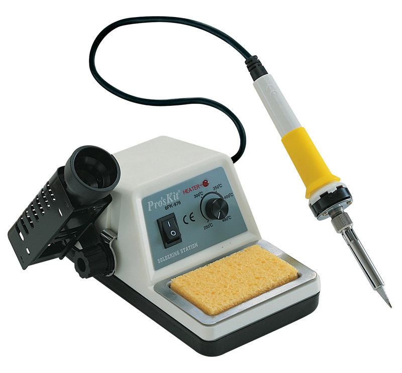

the most common thing seen on many soldering station is a foam pad which is moistened
eg
I do find these somewhat annoying to use
constantly having to wet it
constantly sliding out of its holder
wont clean off encrusted gunk on the tip
to name a few things
I, by far, prefer the ball of steel wool and my 2 stations both use them
