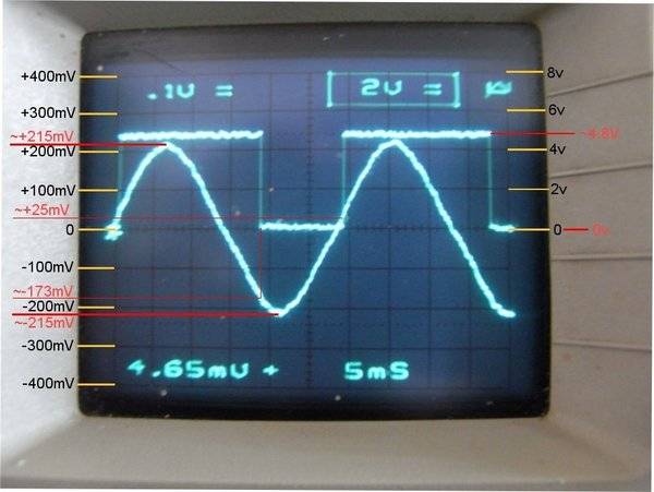

Real signal get.
It is possible to re duplicated the signal condition.?

It looks like the original square wave is simply the result of using the sine wave as input to a schmitt trigger.
The trigger points appear to be +1/3 division and -1.5 divisions. I'm assuming that 0V in in the centre, and I can't figure what the vertical scale is for the sine wave, but I'm sure you know.

Inject a sinusoidal signal instead of the sensor and at the output of the hydrid module in Honda OBD1 must have a rectangular signal of the same frequency than input.
Crank sensor signal = +/- 250mV sinus wave
Crank signal after trigger in the module = 5v square wave
So inject +/- 250mV sinus wave the signal out from module = 5v square wave. If Vin frequency 100Hz then Vout also 100Hz. I check up the frequency in and out was same. But Vout trigger not 5v square wave. What should i modidy to get 5V square wave?

Are you worried that the duty cycle of the output waveform is not 50%?
If so, you need to make sure that your upper and lower trigger points are equally spaced around the centre (0V) line of the sinewave.
That won't happen with that circuit because your op-amp is not powered from a split supply. You need to provide a negative supply rail (e.g. -5V) into pin 4. Without this, the output can't go below 0V.
Your circuit has several unnecessary components and is not very clearly drawn. This makes it hard to follow - for you, as well as for us.
Try using a split supply; preferably more than ±5V - I suggest ±15V. See if that fixes the asymmetry.
