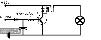

Here is a possible circuit:
attachment.php
The resistor needs to be about 1k (or higher) the transistor can be almost any NPN device capable of switching power to the relay. 2N2222 seems appropriate if you're in the US. Change the timing by changing the capacitor and/or the resistor. Don't reduce the resistor below about 470 ohms or above a few tens of k.

Looks, like that should work, ill have to pick up some parts. Would a 10K pot work for the resistor, or should i just pick up a handful and trial and error it?
If i can't find the transistor you suggest, any guidelines for choosing another?
You could try a 10k pot in series with a 470 ohm resistor -- the resistance should never fall to zero or your transistor will emit smoke.
You want an NPN transistor capable of switching between 500mA and 1A. It's not very critical. The current through the relay should not be more than 50mA I guess, but it's always better to be safe than sorry. The transistor will dissipate a little power as the capacitor discharges, but should not get too hot. It should dissipate under 1/4 watt at the most I expect (and even that, not for long).
I've been debating myself if it would be better to separate the discharge path and the transistor switching point, like shown in the diagram below.
You might want to experiment and see what works best, but I'd want to put a 470 ohm resistor from base to ground anyway.
The most power the transistor will ever dissipate with your 83 Ohm relay is 600mW and the most current it will pass is 170mA.
The MPS2222A that the Shack carries is the same as a 2N2222 (for most practical purposes). It's rated for 625mW & 600mA.
You might also want to consider Shack pack # 276-1617 that contains 5 2N2222's (out of 15) transistors for the price of 3 MPS2222A's.

Well, your circuit seems to work wonderfully, thanks so much for all the help.
Great! But read below.
That will be sailing very close to the wind for a 2222. I had done my back of the envelope calculations assuming a resistance about 4 times this value (and I really should have mentioned my assumptions).
Just check that the transistor doesn't get too hot if you leave the indicators operating for a while. (It may pass through the high dissipation stage quickly enough that the average dissipation is much lower.
One last question, If i wanted to use a different relay with a higher resistance coil, the load on the transistor should go down, right?
I am currently still bench testing the board, but i just left it on 100% for about over 60sec and the transistor didn't get much above room temp.
Ok, After testing i think i may swap the 10K pot for a simple 10K resistor. would is hold a bit longer if I replaced the 470Ohm that is in series with the pot with a larger one? I think it hold's enough as is, but I wouldn't mind it holding a tad longer.
also, any answer on the higher resistance relay question? I would like to replace the bulky auto relay with one that is easier to mount and more compact if possible.
