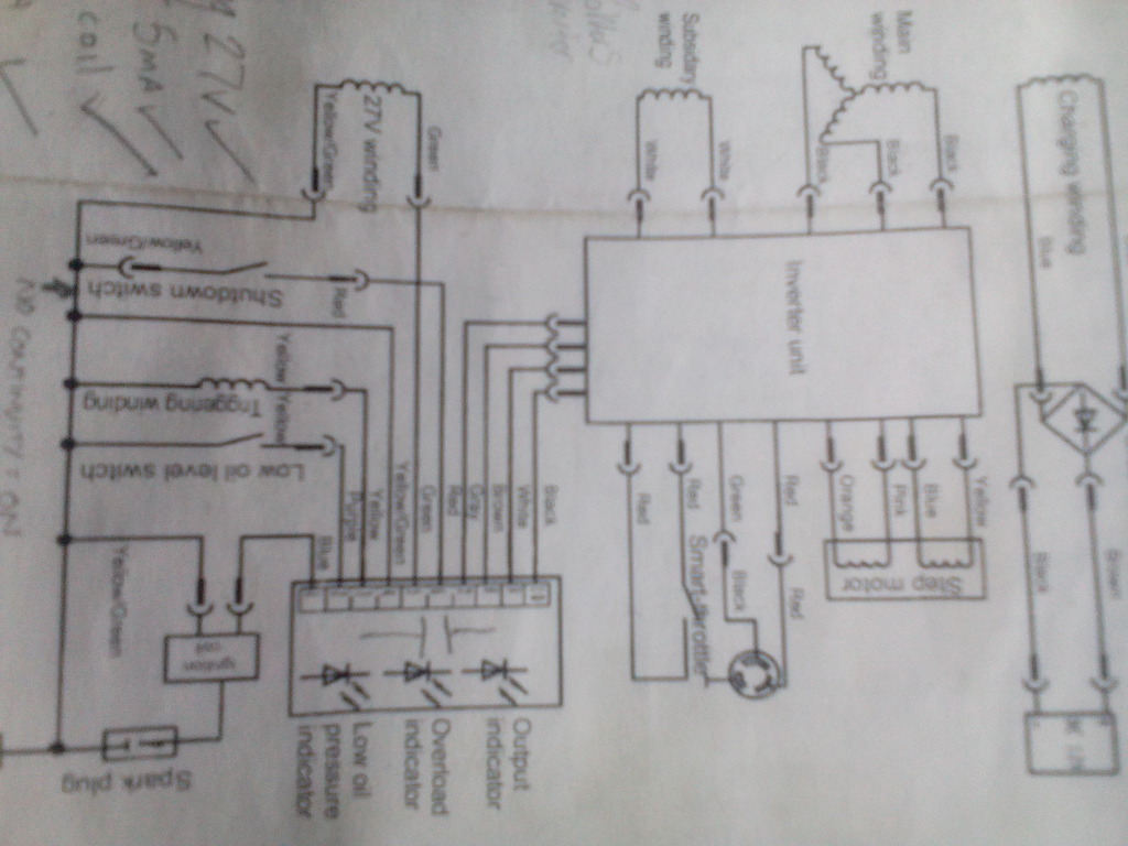

I'm trying to find the fault in an inverter generator, there is no spark, much testing of everything else says to me the ignition power winding is not charging the capacitor, its a 50 v - 2200uf cap, the wiring diagram says the winding is 27 v, on a pull start I'm getting 2-3 v, the trigger pulse is 0.2 v.
Can I disconnect the ignition power winding and replace it with a battery to charge the cap to see if I get a spark ?
If I do I will have found the fault.
