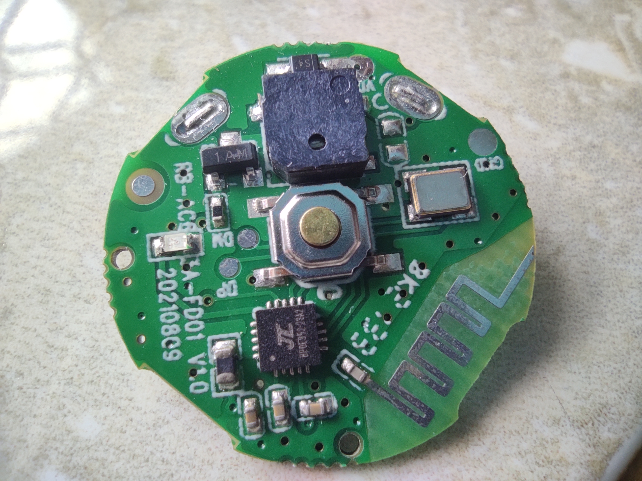

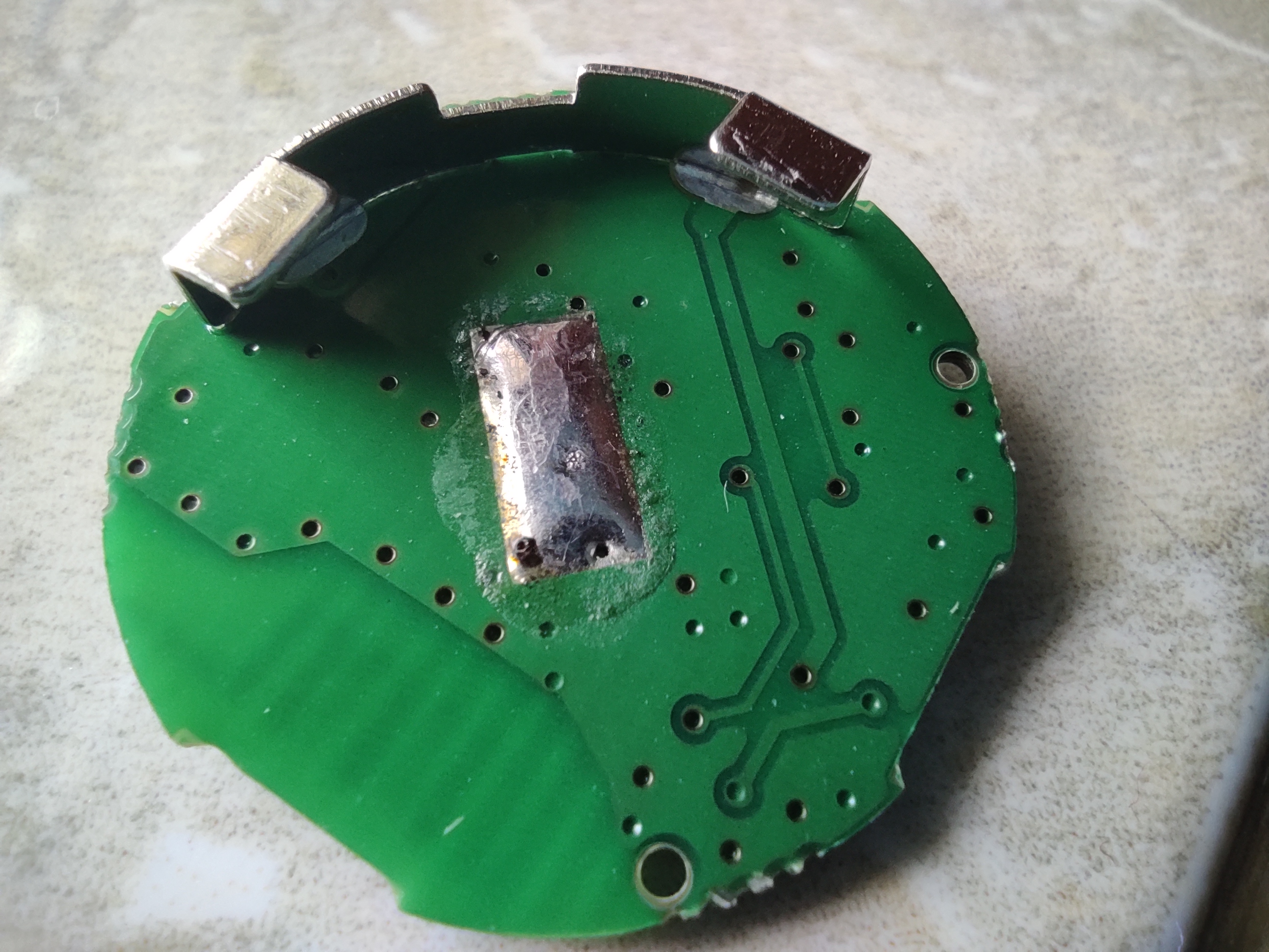

So I have a tuya smart key finder that using Bluetooth technologies, and they claim it can last up 6 month 1 battery, but when I use it, only lasted 1.5 months and it self shutdown.
I'm fed up changing 2032 cells, now I got a thinking.. Can I instead keep using 2032,i wired this device to a single lithium battery (18650 or 14500).
But I'm afraid damaging the circuit, I heard 2032 is 3.2V max, meanwhile li ion has max voltage 4.2V.
Probably second alternatives is putting 3 AAA rechargeable energizer battery it would result 3.6V... What u guys think? I don't mind it getting a bit bigger-atleast it lasting a lot longer.
Here is the device pics :

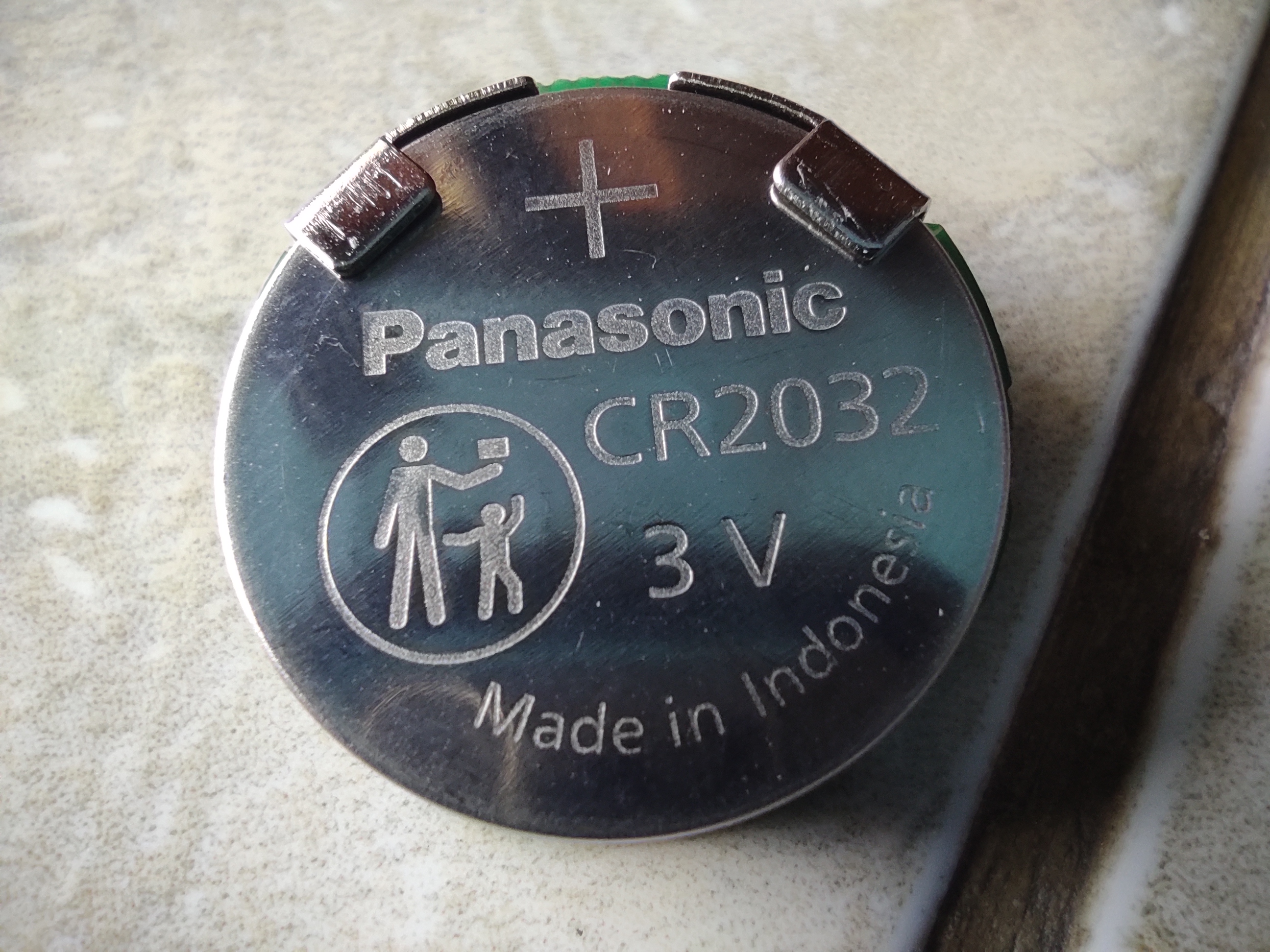

I'd tend to try using quality CR2032 cells first.
This panasonic is the most high quality ones sold in my country.. Got other brands like maxell but fake maxell is everywhere in stores like a plague.
Maybe tell me some brand of 2032 that u think is high quality, and I'll try to look up. The brand I familiar is only panasonic tho. Is panasonic not good?
Btw the original tuya smart key finder is KTS brand, and same it died 2 months after initial use.
