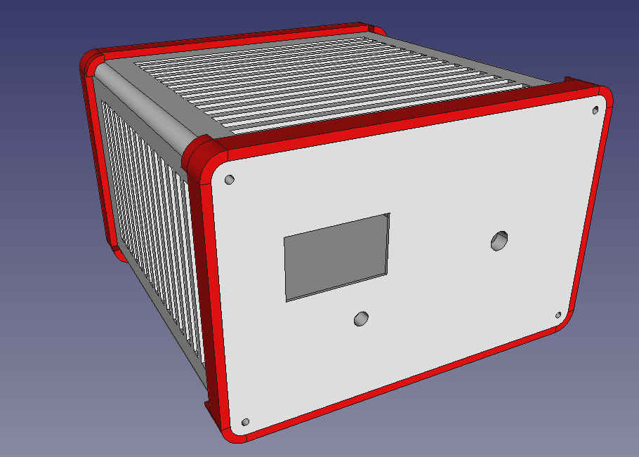

Sometimes 3D printed cases like this from my SMD oven controller:
