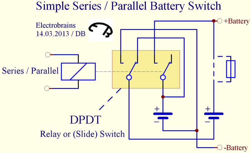

Here is a way to solve the problem:
Remove your SW2 and use a DPDT switch or relay as seen on the diagram below.
In the seen position the batteries are connected in series, in the other position they will be in parallel.
The condition is of course that the batteries have the same voltage and can be paralleled.
As security, you could fuse both batteries or at least the right one (as indicated).
This would be to prevent short circuit if (especially in a relay) a contact would stick in one position.
Also, in the far future, the batteries will get old and if the aging is not synchronous, it might be that suddenly too high current would rush from one battery to the other when switched in parallel.

If I use the circuit suggested by Electrobrains I guess I should connect the batteries in parallel and then connect a 12V charger in order to charge them properly.
