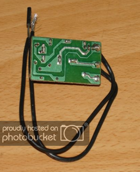

The lamp, in the circuit diagram you linked, is the lamp being dimmed. I don't think you want to change that to a DIAC.I think I am going to make is to change the lamp to a diac on the board. From what I've read, it seems like a better idea.
I didn't plan to dismantle the board I bought. I just bought it so I could basically copy how it was put together.
Since I have no previous experience working with a pcb before I thought it would be a good idea to see what was connected to what.
What kind of issues would interference cause?
