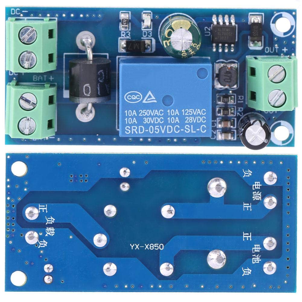

My plan is to use the module below to act as a UPS switch for my small USB powered device.
Parts will include:
1 x dual port USB Female 2.4amp AC adapter plug. = Source to Male USB cord to PCB
1 x 10,000 mah USB battery pack. = Battery to Male USB cord to PCB
2 x USB 2.0 Male (cords cut and split from old parts)
1 x USB 2.0 Female (cord cut and split from old parts) = USB Device (male) to USB Female to PCB load
I planned to charge the battery separately. Can this be done as I plan? Anything I need to know or add for this? Should I use an AC cord with transformer for source? Should the Battery be actual batteries, or can I use one of those $10 packs from amazon. I say this because I think this module can charge a battery as well, and the packs usually differentiate charging vs draw ports.
Thank you!
https://www.amazon.com/Battery-Switch-Automatic-Emergency-Controller/dp/B07X42Z64V
