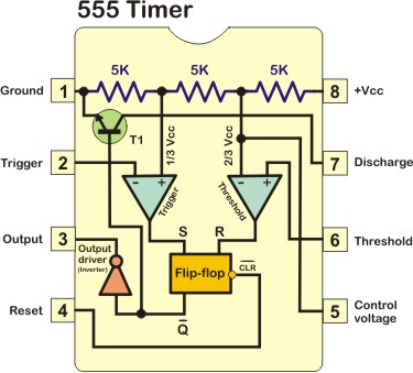

try it without attaching pin7, its internally grounded. Just going from what I read at talking electronics
Pin 7 of a 555 is not internally grounded. It actively goes to ground to discharge the timing capacitor when the output pin3 goes low.
maybe thats his problem, no cap from pin 6 to 0v. I only see a transistor internally and pin 7 being the collector path. I don't see the path from pin 3. Do you know why his 555s are burning up?
The first figure by the OP shows using pin 7 to discharge. In this configuation you need pin 7.
Another configuration is to charge the capacitor towards the output, both high & low, as you've shown. In this confdiguration, no pin 7.
A normal 555 astable oscillator circuit charges the timing capacitor through two series resistors but uses pin 7 to to discharge the capacitor though only one of those resistors making the output not to be symmetrical.
The 555 uses an old TTL design so then the output high voltage is far from the positive supply but the output low goes almost to the negative supply (ground) causing the output not to be a symmetrical squarewave if the output is used to charge and discharge the timing capacitor.
The Cmos version of the 555 has an output that goes "rail-to-rail" so it produces a perfectly symmetrical squarewave when its output charges and discharges the timing capacitor..
Sorry, don't understand. Pin 7 is usually the internal controlled discharge path, so the capacitor will not discharge if not connected to pin 7.
