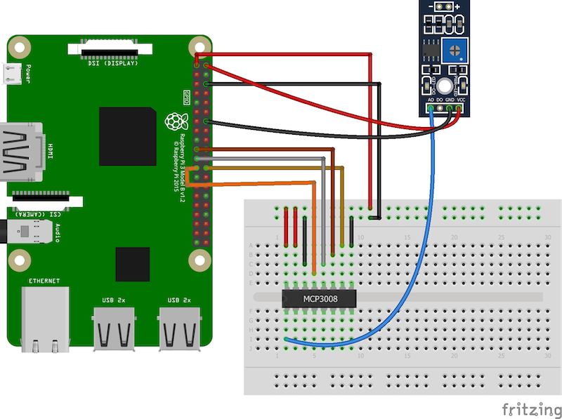

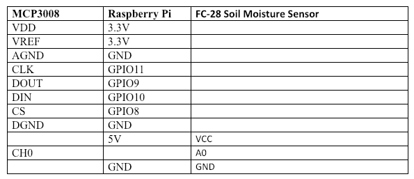

Circuit Diagram and Explanation
The MCP3008 has a total of 16 pins, out of which 8 are used for recording analog input values. The remaining 8, located from CH0-CH7 (pins 1-8), are used to communicate with the Raspberry Pi through the SPI protocol method.
