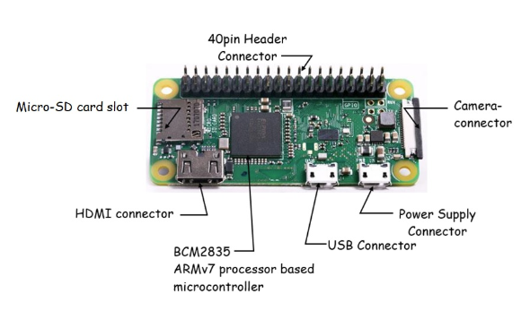

The Pi Zero W has the same features as the RPi. Like the RPi, the Pi Zero W has a microSD card slot, HDMI and camera connectors, WiFi and Bluetooth 4.0 connectivity, a 40-pin general purpose input-output (GPIO) male header connector, and +5VDC mini power connector. The BCM2835 ARMv7 processor-based system-on-chip (SoC) microcontroller powers the Pi Zero W.
Resources provided by the BCM2835 SoC microcontroller include timers, an interrupt controller, GPIO, USB, pulse coded modulation (PCM), direct memory access (DMA) controller, inter-integrated circuit (I2C), four serial peripheral interface (SPI) ports, pulse width modulation (PWM), and two universal asynchronous receiver-transmitters (UART). These internal resources are accessible through the Pi Zero W’s external connectors or computer coding.
Figure 1 highlights the features of the Pi Zero W.
Figure 1. Computer peripheral features of the Pi Zero W.

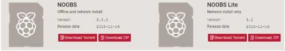

You can install the Linux OS onto your Pi Zero W quite easily using NOOBS. The New Out of the Box Software (NOOBS) provides an easy OS installer containing the Raspbian Linux distribution (distro). Also, included with NOOBS are alternative operating systems which are downloaded from the web and installed onto the Pi Zero W. You can select another version of NOOBS called NOOBS Lite. NOOBS Lite has the OS installer without the Raspbian distro.
Figure 2. The New Out of the Box Software (NOOBS) allows easy install of the Raspbian Linux distro.

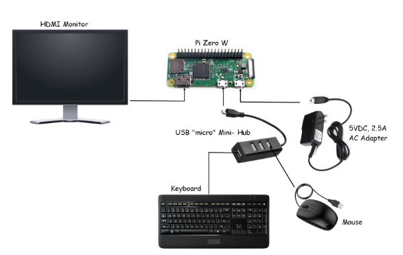

You can attach the computer peripherals to the Pi Zero W using Figure 3.
Figure 3. Attaching the computer peripherals to the Pi Zero W.
Recheck the computer peripherals to ensure they are properly attached to their respective connectors on the PI Zero W. You may insert the 5VDC, 2.5A AC adapter into a 120VAC outlet.

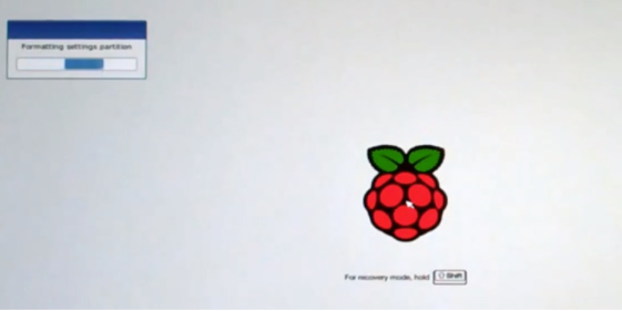

The Pi Zero W will begin the bootup sequence and initialization process and you will see a bootup installation sequence taskbar displayed on your HDMI monitor.
Figure 4. NOOBS boot up installation sequence and initialization process displayed on the HDMI monitor.

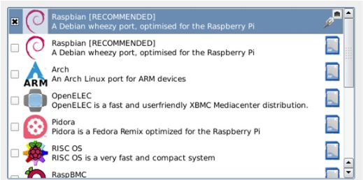

After the boot up is complete, a list of different OS choices will appear. Select the Raspbian Linux distro from this list.
Figure 5. Selecting Raspbian Linux distro. Note: The new version of NOOBS will have the Raspbian Linux distro Jessie instead of wheezy.

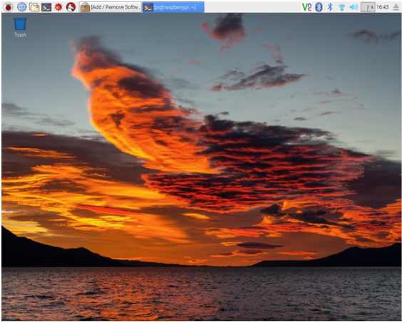

The Raspbian Linux distro will take a few minutes to install onto your Pi Zero W. After the distro installation has been completed, your Pi Zero W will display the Pixel desktop on your HDMI monitor.
Figure 6. Raspbian-Jessie Linux distro displaying the Pixel desktop on an HDMI monitor.

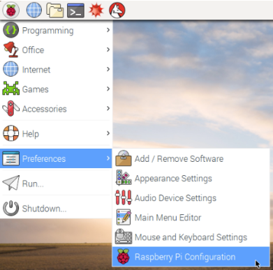

That’s it! You have successfully set up your Pi Zero W. You can change the Pi Zero W settings under Preferences as an exploratory activity.
Figure 7. Changing the Pi Zero W settings with Preferences.
