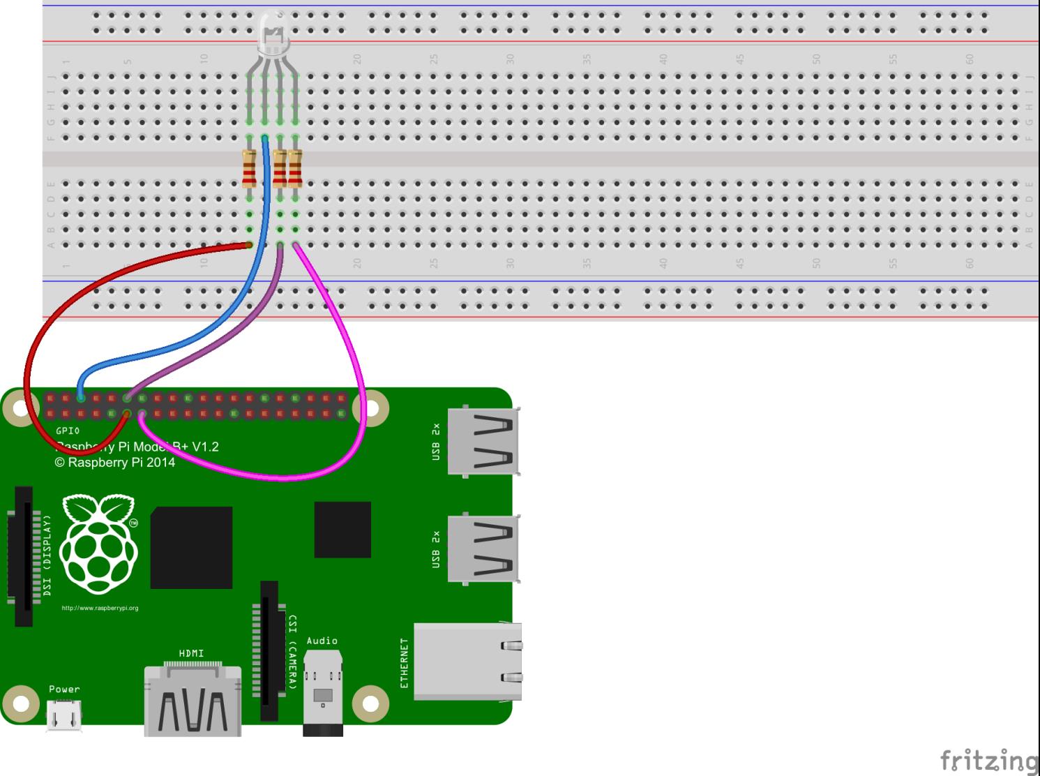

Connect the LED’s GND to the Raspberry Pi’s, and connect other pins to three resistors and GPIO ports. Next step is completing the code. One step before finishing!
