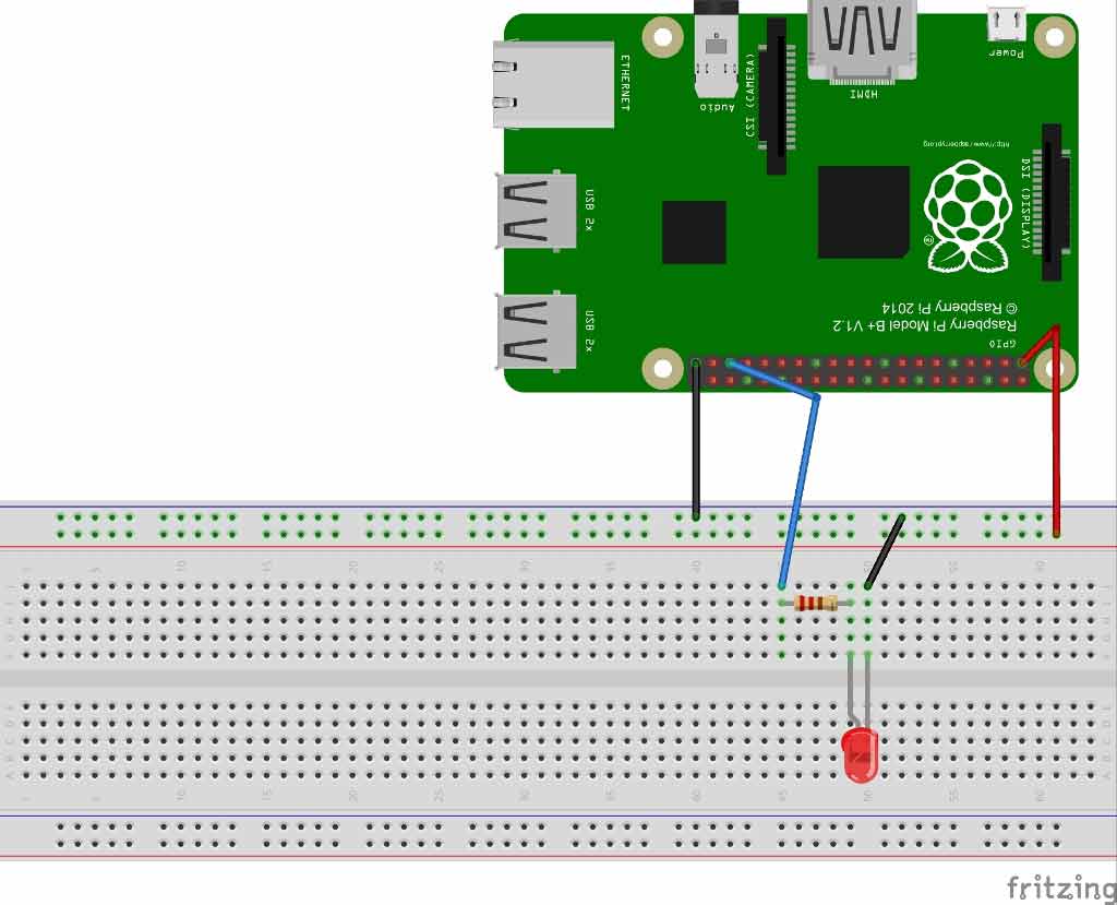

Keep the wiring the same, and save a copy of the code in last chapter as pwm_led.py. If you have a display, click File -> Save as in the Python IDLE or just press Ctrl + Shift + S to save a copy.
