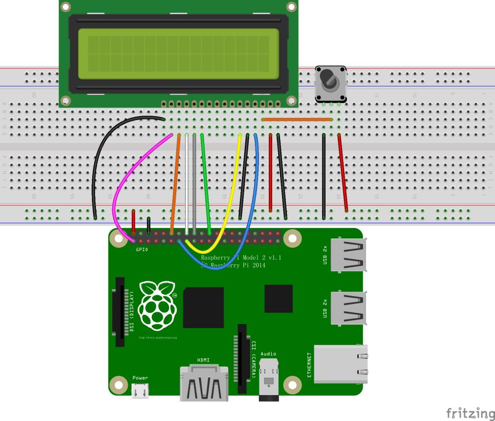

Step 1: Build the circuit (please be sure the pins are connected correctly. Otherwise, characters will not be displayed properly)

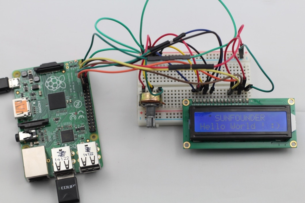

You should see two lines of characters displayed on the LCD1602: "PRIMEROBOTICS" and "Hello World ! :)".
