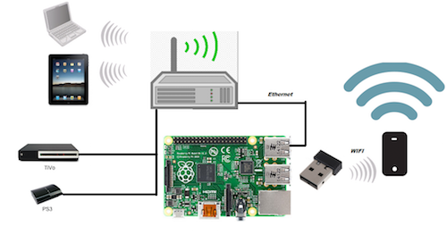

Raspberry Pi network diagram
The Raspberry Pi can be used as a wireless access point to run a separate network. This can be done using the built-in wireless capabilities of the Raspberry Pi 3 or Raspberry Pi Zero W, or using a suitable USB wireless dongle that supports access points.
