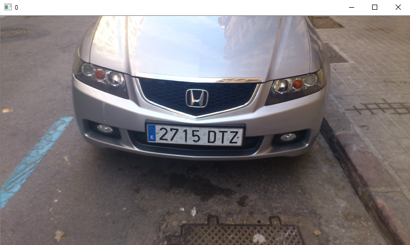

imgOriginalScene = frame #cv2.imread("LicPlateImages/car.jpg") # open image
if imgOriginalScene is None: # if image was not read successfully
print("\nerror: image not read from file \n\n") # print error message to std out
os.system("pause") # pause so user can see error message
return

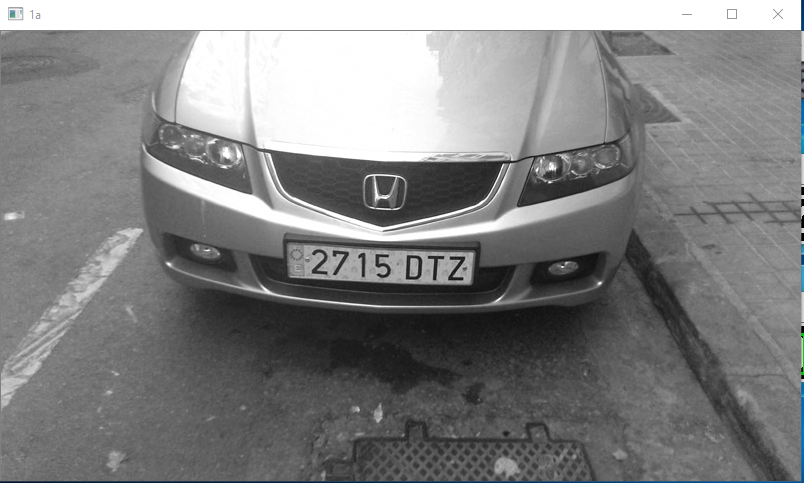

1. Downsampling the image.
imgGrayscale = extractValue(imgOriginal)
def extractValue(imgOriginal):
height, width, numChannels = imgOriginal.shape
imgHSV = np.zeros((height, width, 3), np.uint8)
imgHSV = cv2.cvtColor(imgOriginal, cv2.COLOR_BGR2HSV)
imgHue, imgSaturation, imgValue = cv2.split(imgHSV)
return imgValue

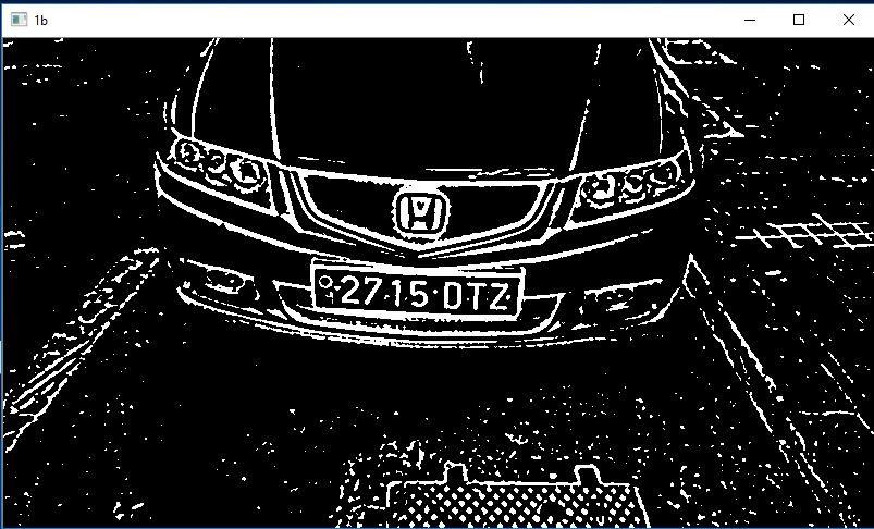

imgThresh = cv2.adaptiveThreshold(imgBlurred, 255.0, cv2.ADAPTIVE_THRESH_GAUSSIAN_C, cv2.THRESH_BINARY_INV, ADAPTIVE_THRESH_BLOCK_SIZE, ADAPTIVE_THRESH_WEIGHT)

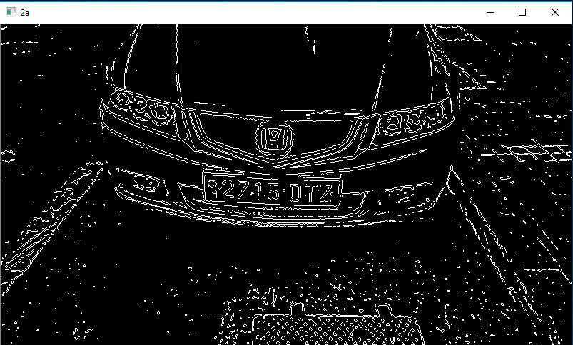

3. Finding and drawing contours.
imgContours, contours, npaHierarchy = cv2.findContours(imgThreshCopy, cv2.RETR_LIST, cv2.CHAIN_APPROX_SIMPLE)
height, width = imgThresh.shape
imgContours = np.zeros((height, width, 3), np.uint8)
for i in range(0, len(contours)):
if Main.showSteps == True: # show steps
cv2.drawContours(imgContours, contours, i, Main.SCALAR_WHITE)

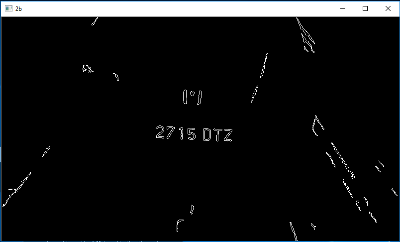

4. Finding possible characters in the image.
for possibleChar in listOfPossibleCharsInScene:
contours.append(possibleChar.contour)
# end for
cv2.drawContours(imgContours, contours, -1, Main.SCALAR_WHITE)
cv2.imshow("2b", imgContours)

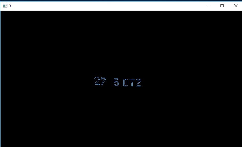

5. Matching characters in the image.
for listOfMatchingChars in listOfListsOfMatchingCharsInScene:
intRandomBlue = random.randint(0, 255)
intRandomGreen = random.randint(0, 255)
intRandomRed = random.randint(0, 255)
contours = []
for matchingChar in listOfMatchingChars:
contours.append(matchingChar.contour)
# end for
cv2.drawContours(imgContours, contours, -1, (intRandomBlue, intRandomGreen, intRandomRed))

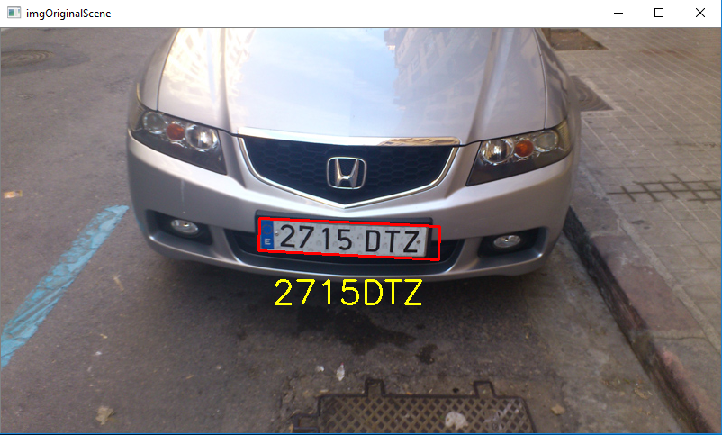

Then we draw a rectangle in the original image and write the numbers below in the license plate.
drawRedRectangleAroundPlate(imgOriginalScene, licPlate)
writeLicensePlateCharsOnImage(imgOriginalScene, licPlate)
You can recognize license plates from other images by adding the images in the LicPlateImages directory.
