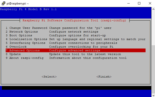

6- Enable VNC and set Resolution
Now we have successfully SSH into the Raspberry Pi and we have to enable VNC so that we can use mouse and keyboard to control it.
Type following command to open configuration tool.
sudo raspi-config
Go to interfacing options.
Select VNC and enable it.

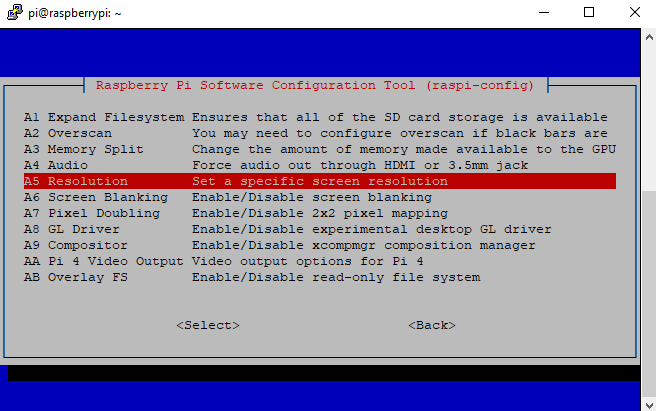

Next, we need to set a resolution for our Raspberry Pi. So go to "Advanced Options".
Then go to "Resolution".
And select a resolution other than default.

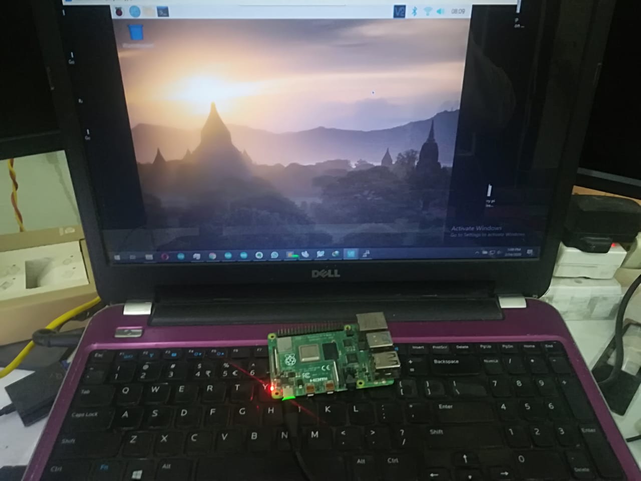

Click on 'OK' and Finally, the Raspberry Pi desktop should appear as a VNC window. We will be able to access the GUI and do everything as if we were using the Pi’s keyboard, mouse, and monitor directly.
