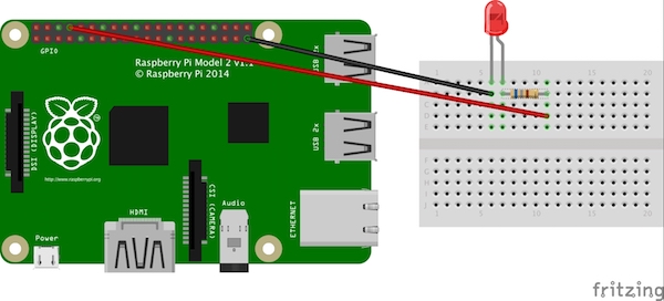

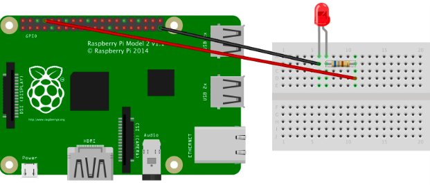

Circuit Diagram: Connecting the LEDs to the Raspberry Pi
First, connect the long leg of one LED to GPIO14, then the short leg of another LED to the Raspberry Pi GND. Use an ohm resistor as shown in the diagram below.
A diagram of how to connect the LEDs to the Raspberry Pi.

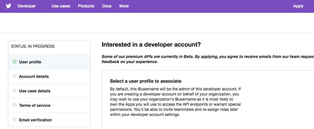

Application and Registration Process on Twitter API
As of July of this year, in order to gain access to the Twitter API platform, all users are required to apply for a developer account.

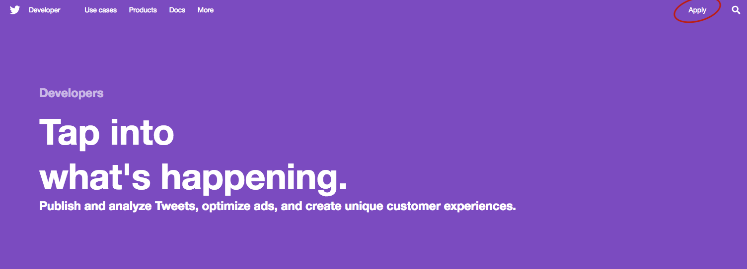

Start the application process on the Twitter API homepage by selecting Apply in the top right corner.
You’ll land on the main developer application page, where you’ll fill out the specific project details, agree to the Twitter API use terms, and submit your application to access the platform.
