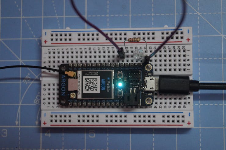

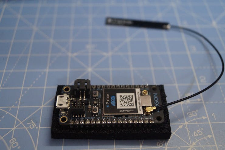

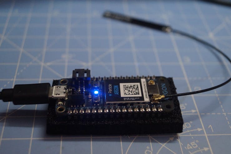

Connect the antenna to the Argon board
Now connect the USB cable and the Blue LED glows.

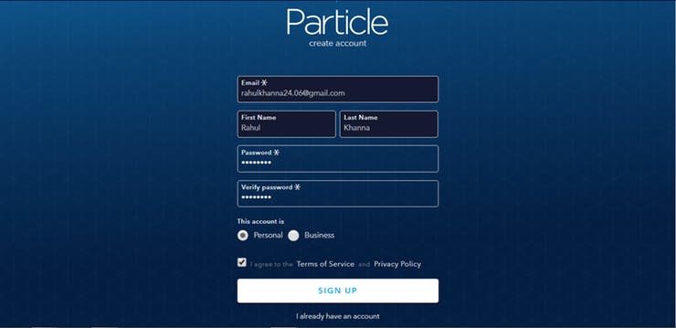

Create a Particle account to register the Argon device.
Select the Argon/Boron/Xenon category and select the Argon option.

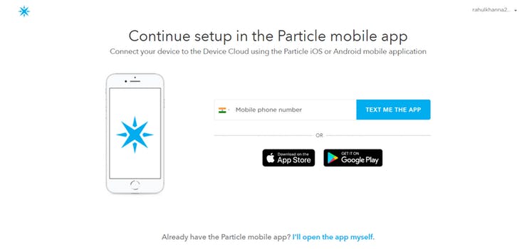

Now download the Particle app from the link. Particle app is available for both Android and iOS.
Connection to the Particle Device Cloud
Login the Particle account and Press + to add your device.
Click on Set up a Argon, Boron, Xenon and Click SCAN STICKER button.
Now scan the QR sticker from the Argon board and the device will be paired with the account.

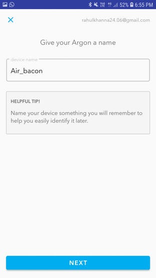

After Setting the Wi-Fi credentials, give the Argon a name. Here I've used Air_bacon

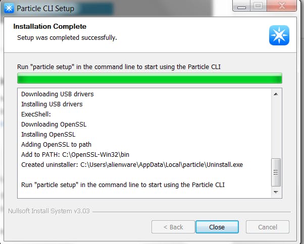

Step 3: Installing Particle CLI
Download Particle CLI (Command Line Interface) to install the device drivers and DFU-util. Refer the documentation from Particle for installation. https://docs.particle.io/tutorials/developer-tools/cli/
Once installation is complete, connect the Particle Argon board to the PC.

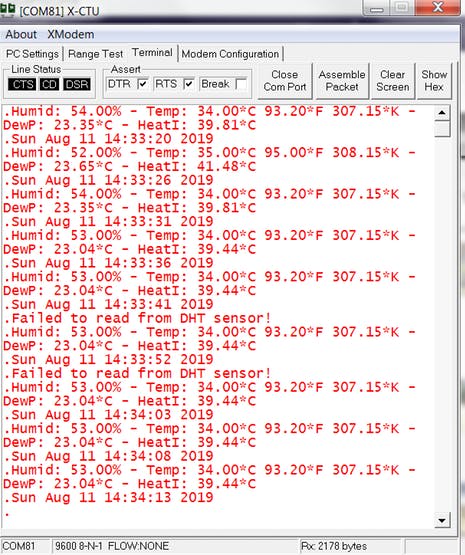

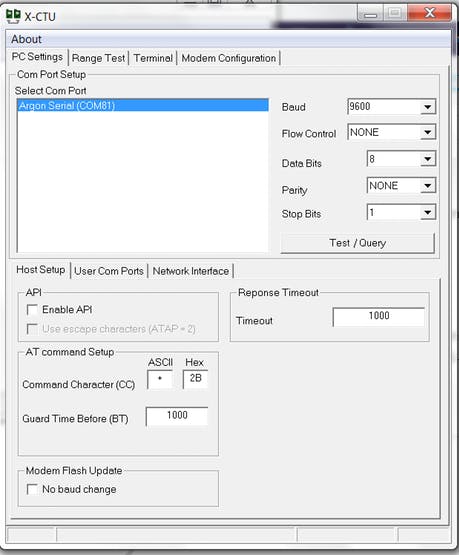

You can find the serial port in the device manager as shown below. (ArgonSerial COM81)
Now open the Particle Web IDE and upload the Serial-test code to the Argon board.
After uploading the code, open any serial terminal with the following config.
In my case, COM81 is opened at BAUD RATE of 9600.
Click the Terminal tab to open the serial port.
By this Step, we can verify whether the serial port is working properly. This can be used to debug at each sections of the code.

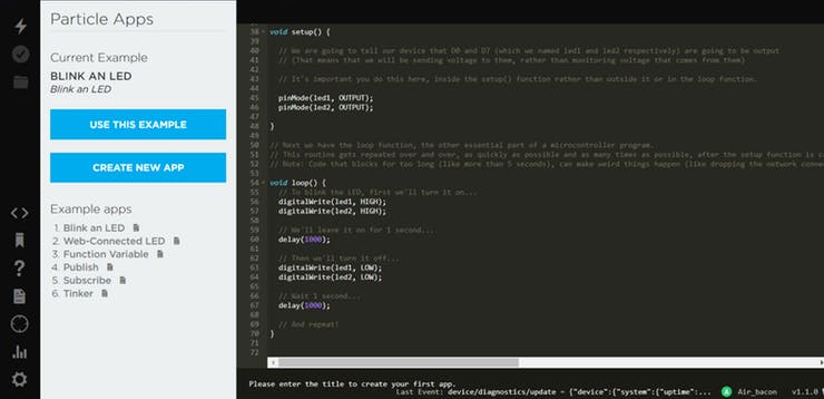

Click on Blink an LED on the left side of the page. The code loads on the right pane. The code is very similar to the Arduino programming structure.
The Argon board has three LED. One LED to indicate the Charging status and other two are used for GPIO.
Now we initialize the two LED and we name it as led1, and led2.
Next we configure the LED's as output
In the void loop function, we toggle the LED's alternatively.
Click the lightning bolt icon on the top left of your screen to flash your code to device. As soon as you click, the Particle Device cloud will compile the program source code to a binary file and send it over-the-air (OTA) to the Argon. You can find the green LED blinking fast after flashing and the device is updated.

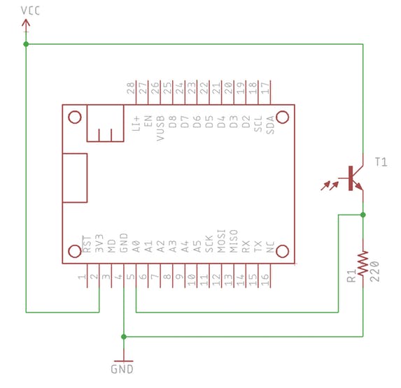

The photo transistor is connected as follows:
  • The short lead of the photo transistor connects to 3V3
  • The long lead of the photo transistor connects to a 220 ohm (red-red-brown-gold) resistor and connects to ground.
  • From short lead of the photo transistor is connected to pin A0.
Overall connections
After connecting all the sensors, the connection looks like this.

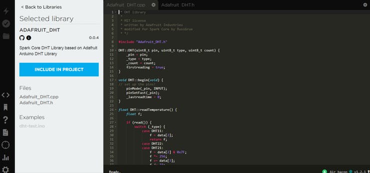

DHT11:
  • Library to the Particle Web IDE
  • Click on dht-test.ino or USE THIS EXAMPLE to fork the code.
  • Change the configuration to DHT11
  • The Output response is shown below.
Since the data received from the DHT11 is too large, it takes several seconds to get the entire data. Whenever it couldn't receive the entire data within the time period it prints the message "Failed to read from the DHT sensor is printed".

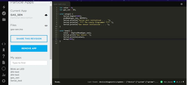

  • Click on gas-sen.ino or USE THIS EXAMPLE to fork the code.

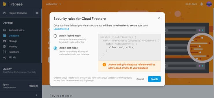

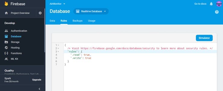

Now Click on Develop -> Database from the side menu, Click the Create Database Button and Start the project in Test Mode as shown below.
Enabling the Firebase will direct you to Data and Rules tab, and verify whether the read and write functions are enabled.
Finally Open Project Settings and copy the Web API Key and the other parameters which will be used in the code.

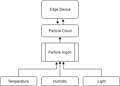

Step 8: Interfacing with Particle (Flowchart)
So this is how it works. First we connect the Particle Argon board to Particle cloud. The Data from the sensors are published to the Particle Cloud via Particle.publish() function. With the data from the Particle cloud, the data is displayed in the GUI. In our case, let's assume that it is a dashboard.
With the above system, we can display the temperate, humidity and light for every time interval.
