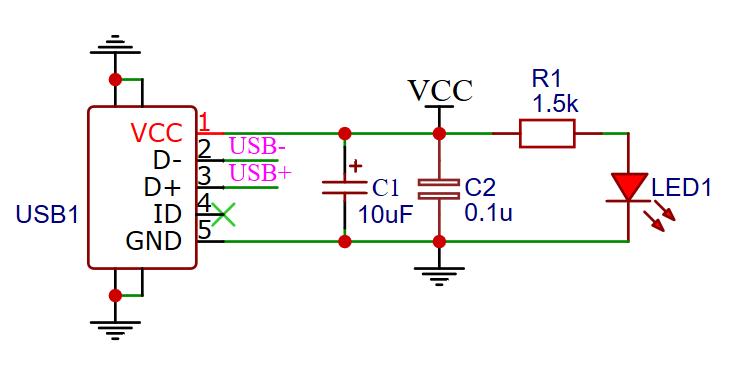

Step 2: Schematic Diagram Description
There are two power filter capacitors C1 and C2 in the figure. Also, R1 is used as the current limiting resistance of LED1. When the power is switched on, the LED will be on (this is the power indicator).

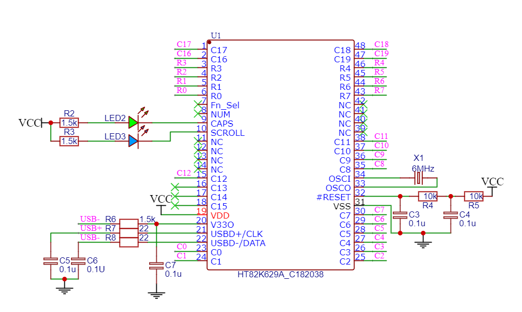

Step 3: Main Control Circuit
In the figure above, X1 is the crystal oscillator circuit, which is directly connected to the crystal oscillator. The size can be 6M or 12M.
R4 and R5 as reset circuits, r6/7/8 as USB circuits. LED2 case lock indicator, LED3 is the rolling lock indicator. As there is no small digit key in key 87, an unconnected identifier was added to Num pin of digital lock to indicate that this pin is not used.

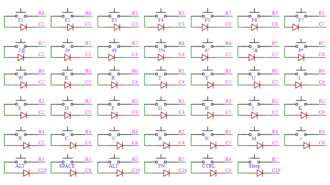

Step 4: A Specialized Circuit
There are several minor problems to be noted in the key circuit. The first is that the direction of the diode is from the R direction to the C direction. If the key is connected backward, it cannot be triggered.In addition, the role of the diode here is playing a full key with no impact, can not be omitted.

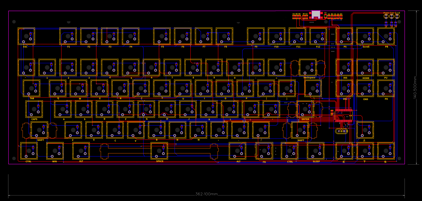

Step 6: PCB File
JLCPCB provides the PCB samples only by $2 for 2 layer board, $5 for 4 layer board.
