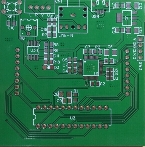

Notes for welding and use:
1 J1 and J2 jumpers are used to choose whether the input signal is left channel signal or right channel signal.
2 The input voltage should not be higher than 5.5V.
3 The R8 on the board is used to adjust the gain. The maximum gain is 10.

PCB Prototype Manufactured by JLCPCB by $2 for 5 pcs

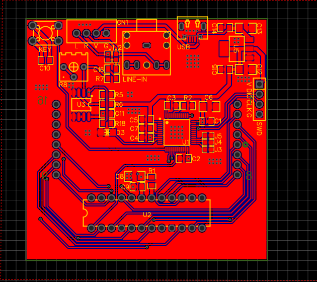

PCB Design File also Enclosed with the Bom List
