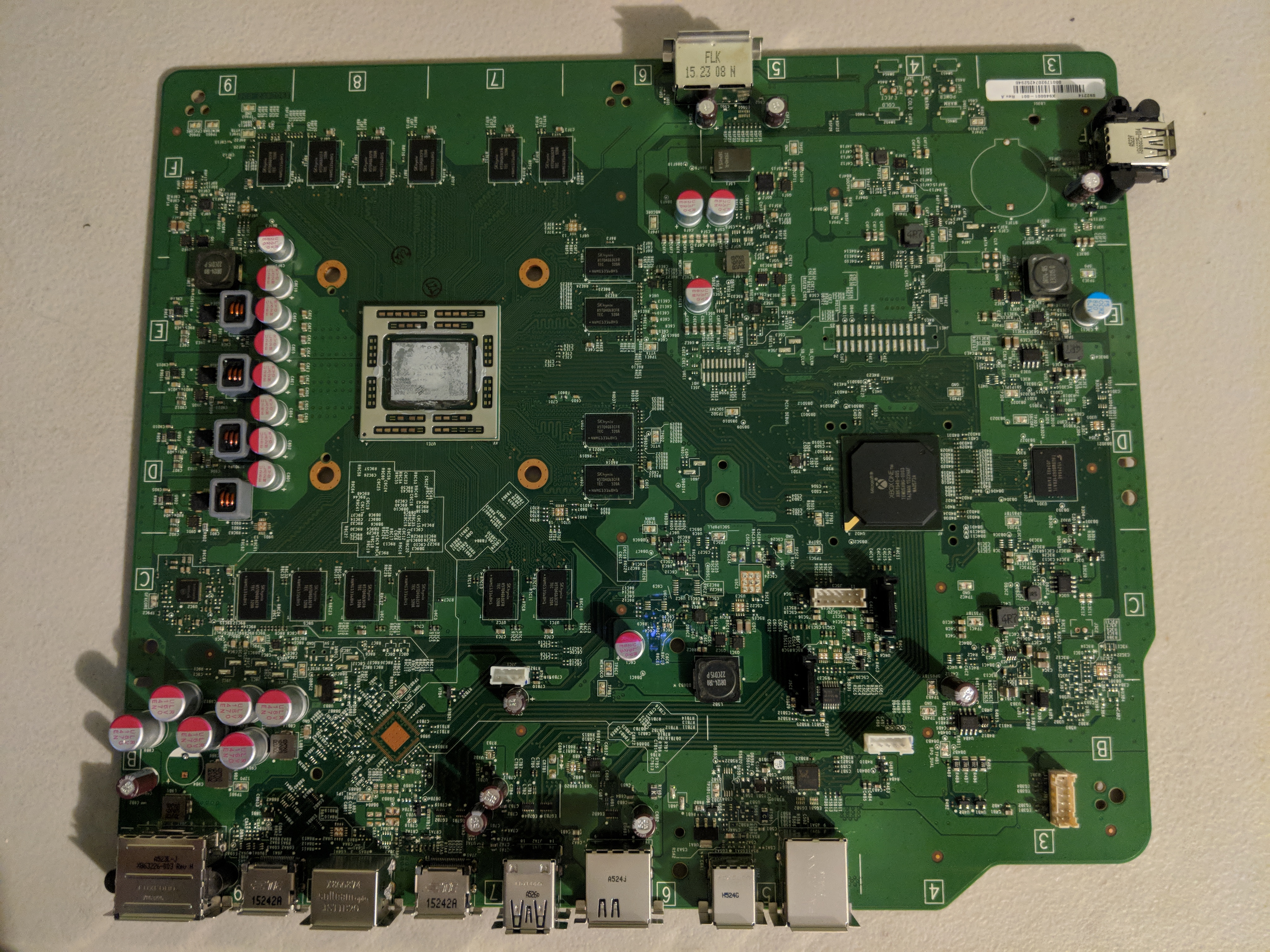

Another question posted earlier .This is an Xbox ONE ,first generation, not a 360, not an S, and not an X .
Attached is a pic of the board .

My revision F board
On right hands side, where red caps are, there are mosfets. These steps usually cited as the cause of power issues. I have a 5th row where you only have 4.
It's my topmost row that is measuring different from the other 4.
