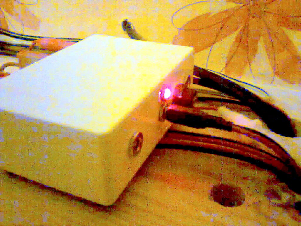

Yes these units if regulated can power your projects, build a small DC connection box with a DC socket in it in one side and drill some holes and add posts or sockets for 4mm plugs and crocodile clips, add a fuse and switch if you want, a latching switch and a momentary switch for short power bursts is useful.
It very much depends on projects you build, they will work fine for a lot of projects, try and get a good quality one with the voltages above, this gives more options powering circuits, you can always upgrade later, a picture of a box i am on about, this one is fixed for radio use, but you can select what voltage you want for a given project.

Add as many switches as sockets or binding posts, sorry poor pictures, only had a phone camera to hand, but a box like this can allow multiple voltages either by multiple pole switches, or posts / sockets.
