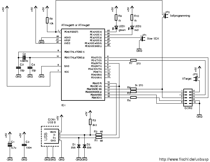

After much frustration I decided to assemble this:
Taken from:Here !
A few things confuse me.
Why is pin 2 and 3 of the Atmega8 connected to the 10 pin socket if only 6 of those pins(excluding 2 and 3 of course) are going to be used as input to the microcontroller that has to be programmed ?
Whats the point of the 4.7u capacitor attached to pin 1 of the USB port?
Is JP1 necessary or is it just to power the other microcontroller when needed ?
Thanks !
