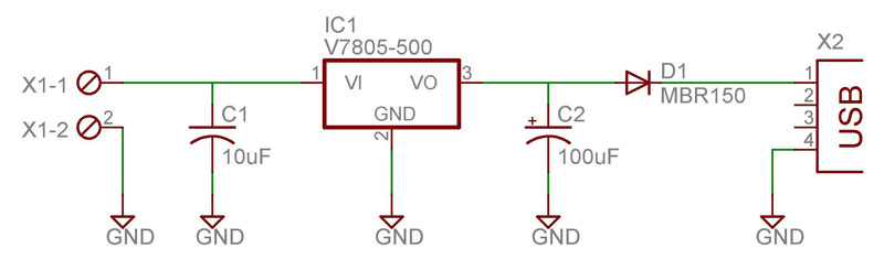

I recently built a modified version of the USB solar charger shown on the DigiKey website. Here's the schematic:
Since I'm using (2) 6V 450mA solar panels in parallel, I modified the circuit to use a 5V DC/DC converter rated to 1000mA instead of the 500ma DC/DC converter shown in the parts list and circuit diagram. The intent was to build a charger that would charge at a faster rate, much like the USB chargers that plug into an AC outlet from which I measure up to 900mA when charging my HTC-brand cell phone.
The problem I'm running into is that I only get around 420mA from the solar charger in full sun. To test the circuit, I removed the solar panels and attached a 6V 1000mA power supply, expecting to draw near 1000mA during charging. But instead, I again only drew around 420mA from the circuit. This leads me to believe there's something in the circuit that is preventing more current from passing.
Any ideas about what could be causing this would be greatly appreciated.

Presumably you have checked the obvious, and tested how much current the unit you are trying to charge will draw if connected directly to a power supply?
Looking at the datasheet for the V7805-1000 it shows a specified input range of 6.5~32 Vdc and output current of 1000 mA. However, that 1000 mA is not a hard limit since the performance charts are shown for output current over 1000 mA. The more likely source of your problem is the minimum input voltage of 6.5 Vdc. What is the output voltage of your 6 volt solar array, especially under full current load?

Yes, when connected directly to a source such as a USB port or AC wall adapter, the phone draws around 900mA.

I'll check the full load voltage of the arrays on the next sunny day I get. But to simulate a greater than 6.5V source, I re-tested the circuit with a 12V 1250mA power supply and got the exact same current draw through the circuit when charging the cell phone....around 420mA.
Another possibility is related to the MBR150 diode. USB power voltage is specified as between 4.75 and 5.25 volts. However, the forward voltage drop of the diode would be about 0.5 volt @ 500 mA. So the solar charger may only be providing 4.5 volts while the AC adapter may be providing 5.25 volts. That difference in output voltage could account for the difference in charging current. Something to check.
Surely that proves the issue is on the output side. Given there's only two components after output, it's got to be something simple (assuming the DC/DC itself is ok).
Check voltages at each point. I'm betting Laplace is right - my MP3 player charges VERY slowly at <5V input, and at <4.5V input it stops and refuses to charge altogether (presumably to protect the Li-Ion cell).
I checked the voltages at each point in the circuit and you are correct that the voltage drop from the diode is about 0.4 volts - thus the device is only getting ~4.6V through the USB cable.
I also confirmed that the voltage output from the AC chargers I've been testing with is 5V through the USB cable to the device.
Could a solution to this be getting a DC/DC converter that outputs ~5.5V at 1000mA? Do these even exist?
Thanks again for all your help...
At least part of the solution will be a MUCH larger input capacitor, bypassed by several smaller ones to reduce the ESR.
The problem with the solar panel is that it is almost a constant current supply under load, and because the DC-DC converter won't be MPPT, it may well be operating the panel at a point where it cannot supply the full rated output.
edit: This answer relates to the suggestion about using a DC-DC converter, not the circuit in the top post.
The 7805 is a linear series regulator. Have you thought about using a shunt regulator instead? If the open circuit voltage of the solar array is 6.0 volts, try using a silicon power diode in series to drop 0.7 volt followed by a 5.1 volt zener power diode to shunt the current to ground. Then the load will be able to pull off all the current at a 5.0 volt load voltage. Sure, you will be "wasting" the current if it is not going to the load, but what were you going to do with that unused current anyway? But you will need a good I-V curve for the solar array in order to make good decisions.

I'm pretty sure I got this working. The device now charges at ~5V and draws nearly 840mA from both a solar array and a 6V power supply when used as inputs during testing. Here's what I did:
I replaced the V7805-1000 voltage regulator with an adjustable LM317T regulator. Using a 470 ohm and a 1500 ohm resistor with this regulator, I'm able to get an output voltage of ~5.4 Volts (measured). This increases the USB output voltage (after the diode) to slightly more than the 5V needed for the device to draw the maximum amount of current available.
Thanks for pointing out that the forward voltage drop of the diode was reducing the voltage seen by the device - I wouldn't have realized that. For some reason the device being charged didn't want to draw full current without the full 5V through the USB cable. But now that I'm getting the full 5V, the device charges at my desired rate.
I'll do more thorough testing in the coming (sunny) days to see if anything gets fried, but so far everything seems to work.
