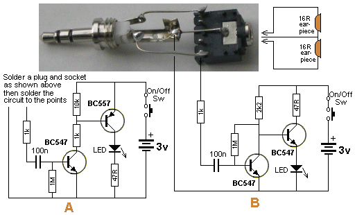

Trying to be a good dad here, but put the project off a bit too long and now have to finish his robot costume by the morning. I'm building a small circuit from components to make an LED flash with sound (so his robot costume will make sound and light up). I'm using the circuit labeled A in the picture below, and it works...but only with the volume turned up very load. Since he will have a speaker on the costume and it will be in his school, it can't be too loud. Is there a modification I could make to this circuit (ie change out a resistor or two) to make it more sensitive to the input? Or, I have some PNP and a NPN transistor left over, could I build a pre-amp? Any help would be MUCH appreciated, because it's got to get done tonight!
Thanks,
Guy
