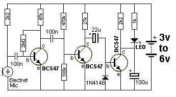

Hello, this is my first post and I was hoping someone could help me with where to find a very long standby Voice Activated Switch circuit.
This project is a tracking responder for high altitude balloon recovery, A gps transmitter gives the approximate location, then a whistle activates a timed beeper when we are close (100m). The balloons maybe airborne for weeks so a long standby of about 1 month is needed.
Perhaps some kind of remote control circuit would do the job?
Any help would be greatly appreciated.

Found a pretty good vox on the talking electronics website, has a QI of .25 mA so on a 750mah lipo it should last for 4 months.:D

hey lovelian can you explain how this circuits works and from where exactly will we take its output?
